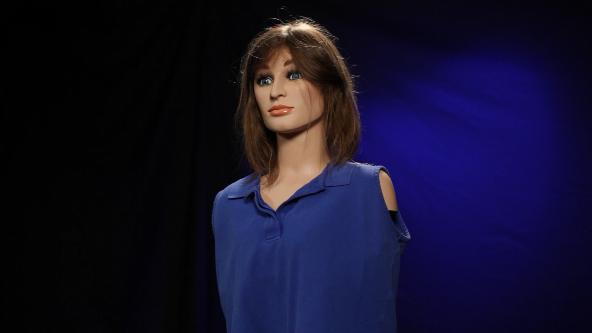

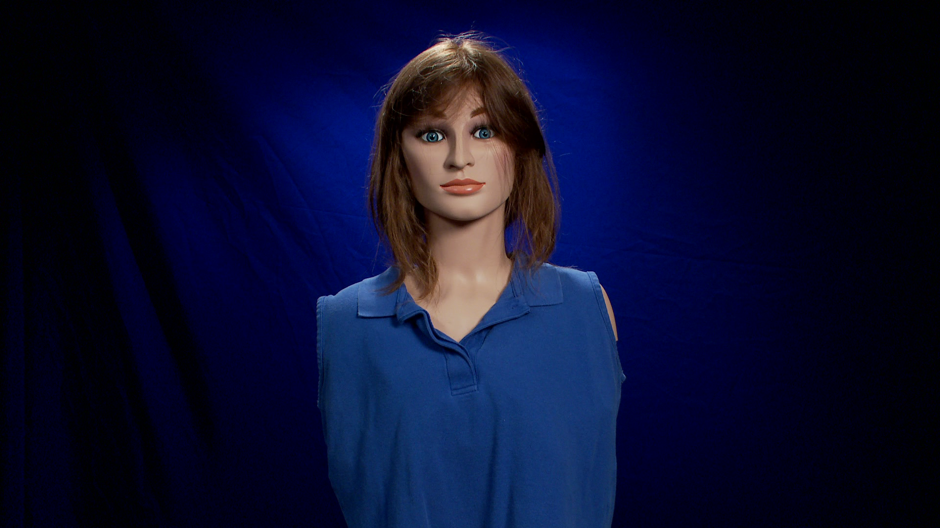

Not to change the subject but, to change the subject. I did some experiments recently and tweaked the 5DM2 color profile to use 0 contrast and 0 saturation. The front shot is the EX1R while the low side shot is the 5DM2. YMMV
EX3 5dmkII Very different looks, but compatible-ex1rfor5dm2.png   EX3 5dmkII Very different looks, but compatible-5dm2forex1r-iso400_-4000.png

Very interesting. I think with colour correction the two can be brought into line, except that the shadows of the 5D/2 image demonstrate the inherent crushed blacks that the 5D/2 suffers from.
With contrast and saturation turned down, I have been unable to eliminate this problem satisfactorily. Fine if you like heavy contrast but not so if you prefer subtlety.
The EX1 image looks much sharper - what lens did you use with the 5D/2?
If you can supply the iris / aperture settings you used on both cameras, that would be useful too.
Thanks for posting the pictures - (I hope your model learns to relax a little more for the next shoot)!

Yes, it was as close as I could get it in camera. Any more saturation and the skin tones are too warm, yet the blue shirts are not quite the same.
The EX1R is spot on color wise to my eye. The POV of course is different between the cameras and I don't know how much that plays into it.
Your point about contrast is well taken, I think I'll drop the 5DM2 back to Olof's recommended -4
EX1R: f1.9 with Sony VCL-EX0877 Wide Angle Adapter
5DM2: Shutter 50, ISO 400, f2.8 with Sigma 50mm f1.8 lens
I'm still getting used to the 5DM2 camera in the studio. The depth of field is quite shallow for getting the entire head in focus at this range. I focussed on the lips and the left shoulder was in focus while the right side of the head was a bit soft. Next time, I'll focus on the right eye. Then there's the moire in the hair......

Thanks so much for this post Les.
I can't believe how good the EX1-R image is with the W/A Adapter.
