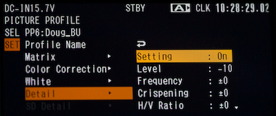

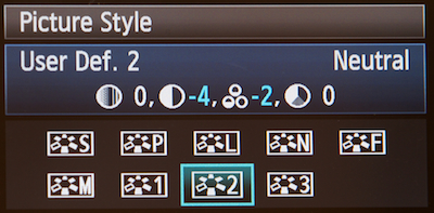

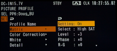

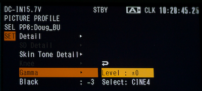

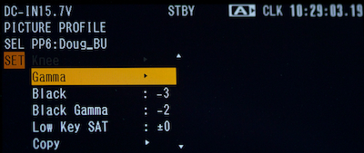

Here are my settings for 5DmkII and EX1R/EX3 (these are based on Doug's recommendations and work very well, I made slight adjustments from his). If there are any color shifts I fix them in Color, usually very slight adjustment in highlights only. Also either use 5600 in each camera or custom set both WB's. This is crucial.
