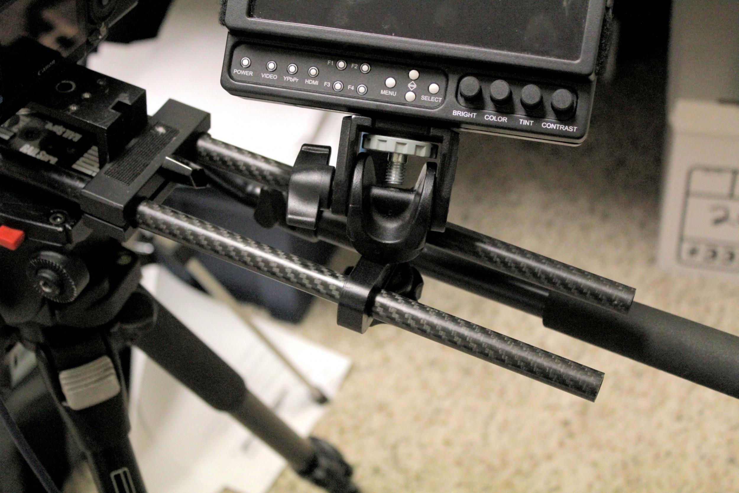

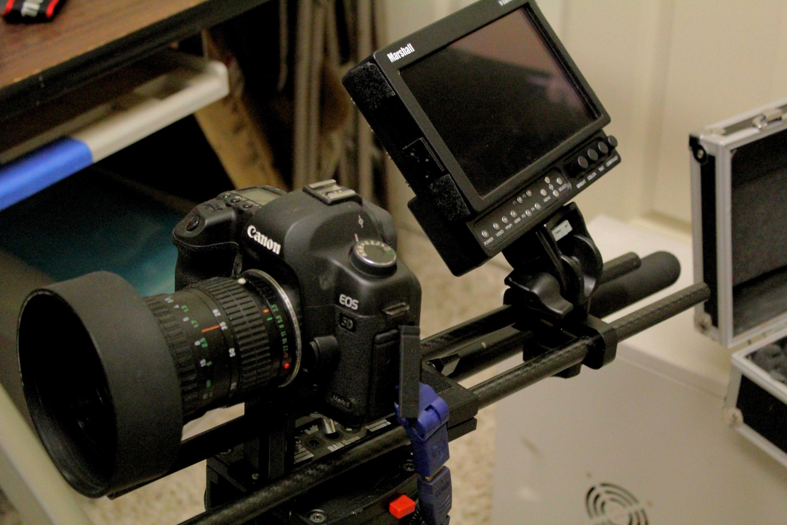

You will need to get an adapter to plug into the monitor from the AV Video jack. It is not RCA.
Also, be aware that if you are using camera to record sound, there is the potential off feed back from the monitor. When I did that with an LCD4Video monitor hooking up that, I did get buzzing. So when I got the Marshall, I was happy to use HDMI. I am happy with the results of the HDMI feed, even when the camera switches to low rez at time of recording.
You will not want to mount the monitor off the hot shoe. It will rip it off. My hot shoe is loose just trying to mount a ligher accessory.
I use rails to mount the monitor in back of camera when tripod shooting. At other times, you can mount monitor on a cheap tripod next to the tripod with the Canon on it.
See pictures attached below of rails. When I am shooting on shoulder, I opt for eye loupe to focus.

Rails: indiSYSTEM - indiRAILSpro 12
Mounts to mount on Rails: DIY Rail Mount - Standard Rail Mount Accessory for your DIY Projects - dfocussystem.com
I also use the DFocus Follow focus: D|Focus - The Affordable Follow Focus - dfocussystem.com
With these lens gears: D|Gears - Affordable Universal Lens Gear System - dfocussystem.com
Swivel is a Manfrotto 3232 : http://www.amazon.com/s/?ie=UTF8&keywords=manfrotto+3232&tag=googhydr-20&index=aps&hvadid=3987404725&ref=pd_sl_ycnfi0xk2_e
About glide cam, that monitor will come in at about 2 pounds with a battery if you mount it. With a steady came, you won't beable to touch camera to to focus anyway, so you are prefocusing your shot and all you need to do is frame.

That cover piece is a good idea. I had my homemade unit on my T2i and managed to burn a portion of the LCD.
For hand held, I think best way to go is with an eye piece.
But a monitor is needed to for your low angle tripod shots, dolly and jib shots...
I really like the Marshall for those needs mounted on the rails with the swivel..
Chris J. Barcellos
