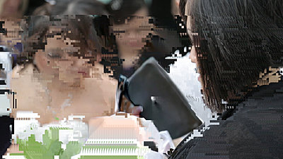

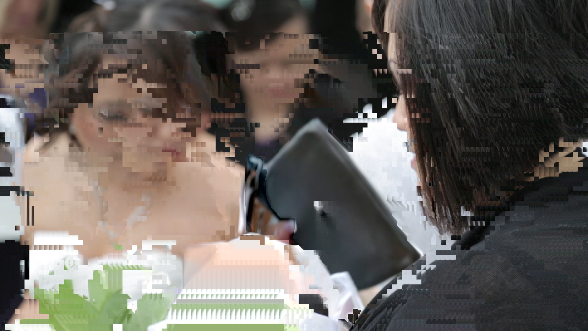

5dMk3 Pixelation - Corrupt Files?
I've shot a few projects on the MkIII that I rented twice from two different rental outlets, so I know it was not the specific camera. On some shots during certain frames I get some pretty bad video pixelation/distortion. Attachment below.
Any idea what caused this? I'm using the same high speed cards I use on my 7D and 60D with no problems.

Re: 5dMk3 Pixelation - Corrupt Files?
Could be a number of things
- The CF cards you used to shoot with are corrupted, hence the files are damaged - might want to give those CF cards a complete check-up just to be sure!
- Something went wrong when copying the files from the CF to your editset
- You editset's codec is broken, try re-installing it
And it could probably be something completely different - but these are the most likely culprits in my mind. Hope you can fix the problem!

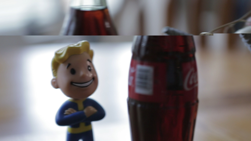

For a single frame I had this happen in one of my clips directly from the camera. This is how it was recorded. Hasn't happened before or since.
The failure mode seen on the pictures posted above corresponds to a bitstream defect inside a frame.
Picture is cut in two because QuickTime H.264 decoder stops working when it finds a defect.
The bottom half of the picture corresponds to the previous frame (not refreshed).
We have seen that also on Canon Mk II, and we were able to fix it in a few occasions:
Not a complete failure Blog Archive The Everest of movie repairs
But it's a very complex repair, if ever it's possible.
Advice: Try a different card. Try a different camera with the card. Figure out whether camera or card is causing the problem, and replace it.
