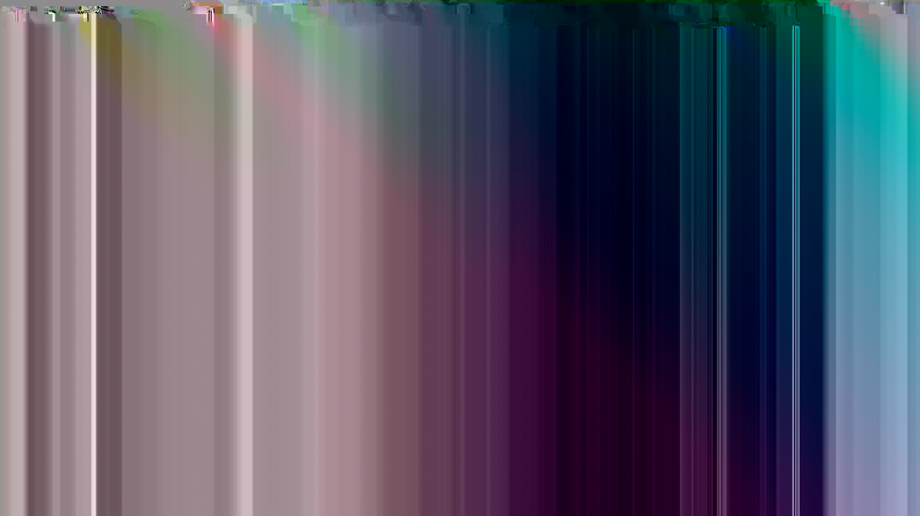

I've been using a MK II for the better part of 3 years. I just picked up a MKIII. Most of my shooting only requires short clips. Friday I had a shoot that required longer record times. Every clip that I recorded over 5 minutes and 40 seconds has artifacts like the attached image. The sound is still there. Treasured is able to restore it. However, I'd like to isolate the problem and figure out a way around it.
As a test I put a different CF card in the MKIII. The same result happened. At 5:41 and on, the rest of the video was all artifacts. I also put the original card that I noticed the problem on in my MKII and recorded a long clip. There was no artifacts.
Any ideas?
Thanks in advance.

I'd be thinking of returning it. None of our mk3 bodies do this.

Not that it is card specific but please give a little more detail. CF or SD? What brand? etc. thanks

I haven't seen anything like this on my camera. Has you camera been dropped. Is it overheating?

Nope Nothing like that here. Defective camera would be my guess.

No problem with mine. Sounds like a defect to me.

Do you see the same thing in the LCD while recording? I guess your camera needs to be returned.

John, does the camera have the original firmware? Just thinking that a bad installation of something like Magic Lantern might be driving this.
Do you see the problem when playing back the clips in camera, or only on the computer monitor. If the latter, then maybe a graphics card driver issue, but I wouldn't have thought that would only show on clips of a certain size or greater.
Have you tried different resolutions and frame rates? If I had to guess, I'd say corrupted files. You say you have tried different cards. What were those cards, and were they formatted in the camera or on the computer. Sorry to ask obvious questions, but you just never know.

Same thing is happening to me. Here's the post I just added, along with sample frames:
http://www.dvinfo.net/forum/canon-eo...ml#post1782531
Mine are only happening for a frame at a time but are happening to almost every clip regardless of duration and card use.
I'd love to know if you or anyone has gotten to the bottom of this...

That really sucks. I would be PO'd. Pretty sure it is the camera, maybe try re-installing the firmware.

Another video producer I know said it looks like "data corruption of some sort. Dropped packet data. I've seen it before on downloaded movies from the net." If that's the case, could it be the card??

Response from the Melbourne service centre (spelling mistakes included):
"The faulty is a corruption: cane be caused by a card or camera.
Theses sensor or the main board can produce this fault or a faulty card.
Try a new card first and see how that goes.
If a new card does not work the camera will have to go to Canon Sydney"
So if it's the card, fine. If not, bad news. Especially since I bought it in Hong Kong...

Ok, so I'm confused.
As I started ploughing through all my footage from all cards to see if I could find other footage affected, I could not find one example.
Which initially made me think it was just the card.
Then I got to the footage that had been affected when I had (repeatedly) viewed it last night.
Tonight though, no problems!!!
All clips played perfectly!
I just don't understand it! Does that suggest some problem with my MacBookPro??
