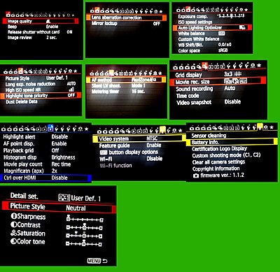

I traded my 7D for a 6D recently, and was thrilled about the increased sensor, until I started to review my video experiments. I loved the look of, for example, a 50mm 1.4 on the 7D. At first I thought I would get the same basic results with the 6D, just larger. So far I'm kinda worried...
There is a lot of noise all the time, blotchy fuzzy grain, and nothing is very sharp, even when tested using one of the contrasty presets and a fast lens on f1.4. Watching it played back the fuzz looks nasty until I pause it, at which point I see an almost-usable still image. I'm wondering if there's something obvious I have neglected to set up in the slightly different menu. I almost feel like I'm recording SD or 720p.
I've had to do radical noise reduction just to get the noise down below ugly. Here is a video of what I'm talking about (with the ISO cranked, but the fuzziness is always there), and some of the NR first aid I've been doing.
On the 6D I have been using Canon EF 17-40mm L and a Canon 50mm 1.4.
Please take a look at my settings and tell me if I'm overlooking something obvious.
Thanks people!
7D to 6D woes! :(-6d-trouble-settings.jpg

Casey, i can see this...
Auto light optimizer is on off it should be standard.
Long exposure noise reduction (this may be wrong defo) turn off you have it on auto.
turn contrast all the way down on video!! sharp all way down sats are good
ok for stills.

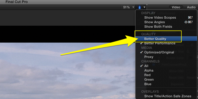

Originally Posted by Casey Danielson View Post
Thanks, Steve. My main confusion right now is over why my footage--1080p/24p--looks so piss-poor when I viewed in normal viewer apps (iPhoto->Quicktime, FCP X, After Effects 5.5 and MPlayer, but looks comparatively excellent when rendered. ???
I would assume the FCPX is set for performance rather than higher quality playback. You can toggle it to display higher quality video preview.
7D to 6D woes! :(-screen_shot_2014-02-25_at_6_37_46_pm-4.png
I knew it! Something really simple. I'll give it a shot at the NLE tomorrow. Thanks, fellas!
