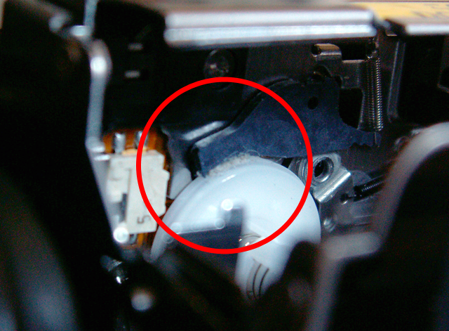

Greg Donovan June 18th, 2009 11:22 AM
Ron,
I'm guessing that this is the post you were referring to. The photos do not work, but I took some of my own and I was wondering if you would be able to tell me if I am looking at the right part.
http://i223.photobucket.com/albums/d...L2/gl2fix2.png
http://i223.photobucket.com/albums/d...L2/gl2fix1.png
Greg

Greg Donovan June 19th, 2009 06:00 PM
YES!
I put some alcohol on a microfibre cloth and cleaned that little piece of friction fabric stuff on the black plastic rocker (with the spring on it) and used a dropper to put a couple of drops of alcohol under the white gear. I then spun the gear by hand and left the camera for a couple of hours to dry.
I picked it up, turned it on, put a tape in, hit play, I played the tape (the cam wouldn't even play tapes and I was having problems when I turned the camera off, the tape was not going back in the cartridge and giving remove cassette errors upon turning the camera back on) and then I went to rewind at slow speed, it gave the error. I turned the cam off and removed the battery for a few seconds. I put it back in and powered on. Tried full speed rewind - success (for only the 3rd time in owning the camera!), I then fast forwarded to the end of the tape and rewound back to the begining a few times. No issues at all. It plays and does slow fast forward just fine and gives the error the odd time (maybe every 3 times) I use slow rewind.
Unless it gets any worse, I don't plan on cleaning it any more. I'm overjoyed right now. Because of the problems I was having whenever I turned the camera off in record mode, it wasn't simple a playback error for me (and I do have another cam to use as a deck) but it was making the camera unreliable for shooting at all.
I can finally get excited about getting this camera again.
Greg
Edit: Ok, scratch that. I have it another couple of drops and it works absolutely flawlessly now. Flawlessly.
