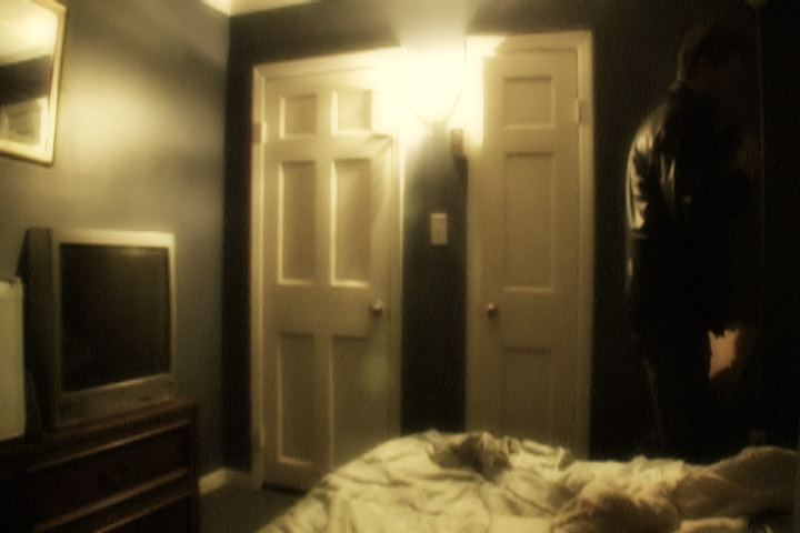

I've had my WD58H on my GL2 since I got it last Fall and never taken it off, I attached a screen capture of a "final" shot from the film I am working on.
