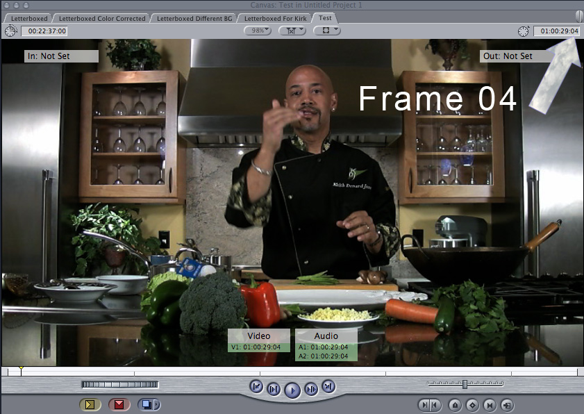

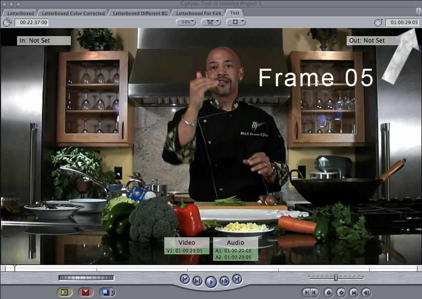

Old March 8th, 2008, 08:31 PM   #15
Location: Highlands Ranch, CO
Posts: 336
Hey Austin,
Here is the process that I used to reverse tele. in compressor:
1. In Final Cut Pro, Log and Capture your clips shot as 1080p24 from the HV20 using the Easy Setup named
"HDV, 29.97, HDV - 1080i60 FireWire Basic".
2. In Compressor, choose Add File and navigate to the capture scratch folder for the clips you captured and
open them all.
3. Select the first clip in the batch.
4. Choose the setting named "Apple ProRes 422 for Progressive material" (found in Settings tab > Apple > Other
Workflows > Advanced Format Conversions > Apple Codecs), and drag it onto the first clip.
5. Double-click the setting on the first clip to highlight the Inspector window.
6. In Inspector > Encoder Settings > Video Settings, change the framerate to Custom, and enter 23.976.
7. In Inspector > Frame Controls, enable Frame Controls and make the following settings:
1. Set Frame Controls to On
2. Set Deinterlace to Reverse Telecine
So here are a couple of screen shots that depict what I am talking about. If you look at the time-code, you will see that there are two frames back to back that are identical (duplicate frames).
HV20 23.98/24P workflow. Frustrated!-frame-1.jpg   HV20 23.98/24P workflow. Frustrated!-frame-2.jpg
Ryan Mueller is offline   Reply
