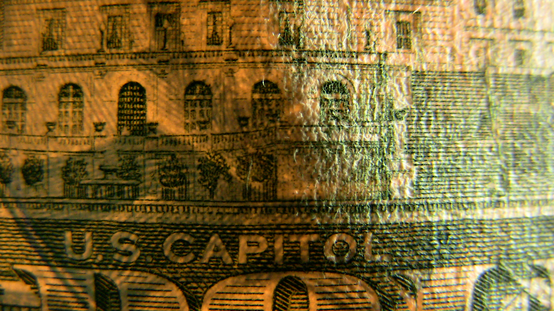

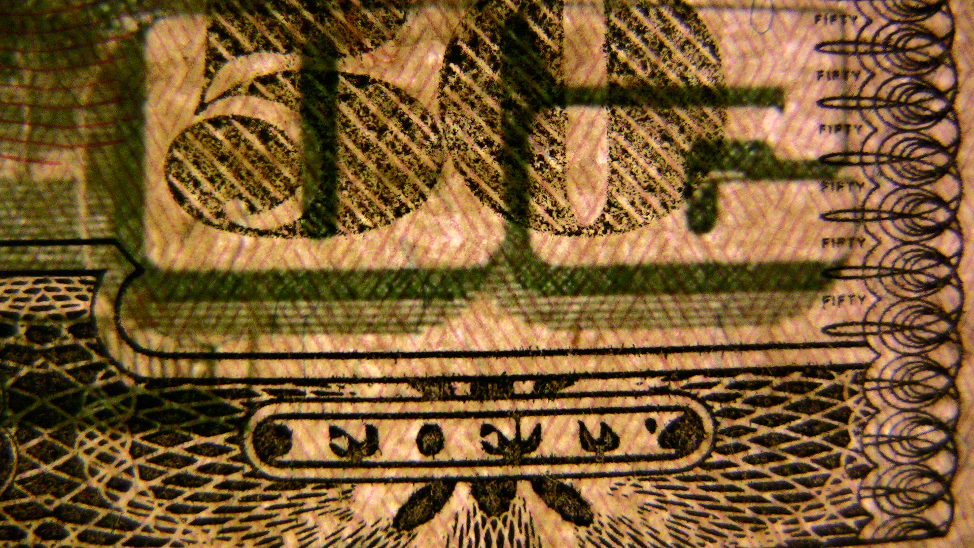

How's this for built-in macro capability (click to see 'em big)...
Macro-Closeup Videography HOW?-img_0109.jpg   Macro-Closeup Videography HOW?-img_0111.jpg

Hi Dave, take the lens hood off of your GL2, provide plenty of light, zoom out to full wide and you can focus on objects touching the front of the lens.
