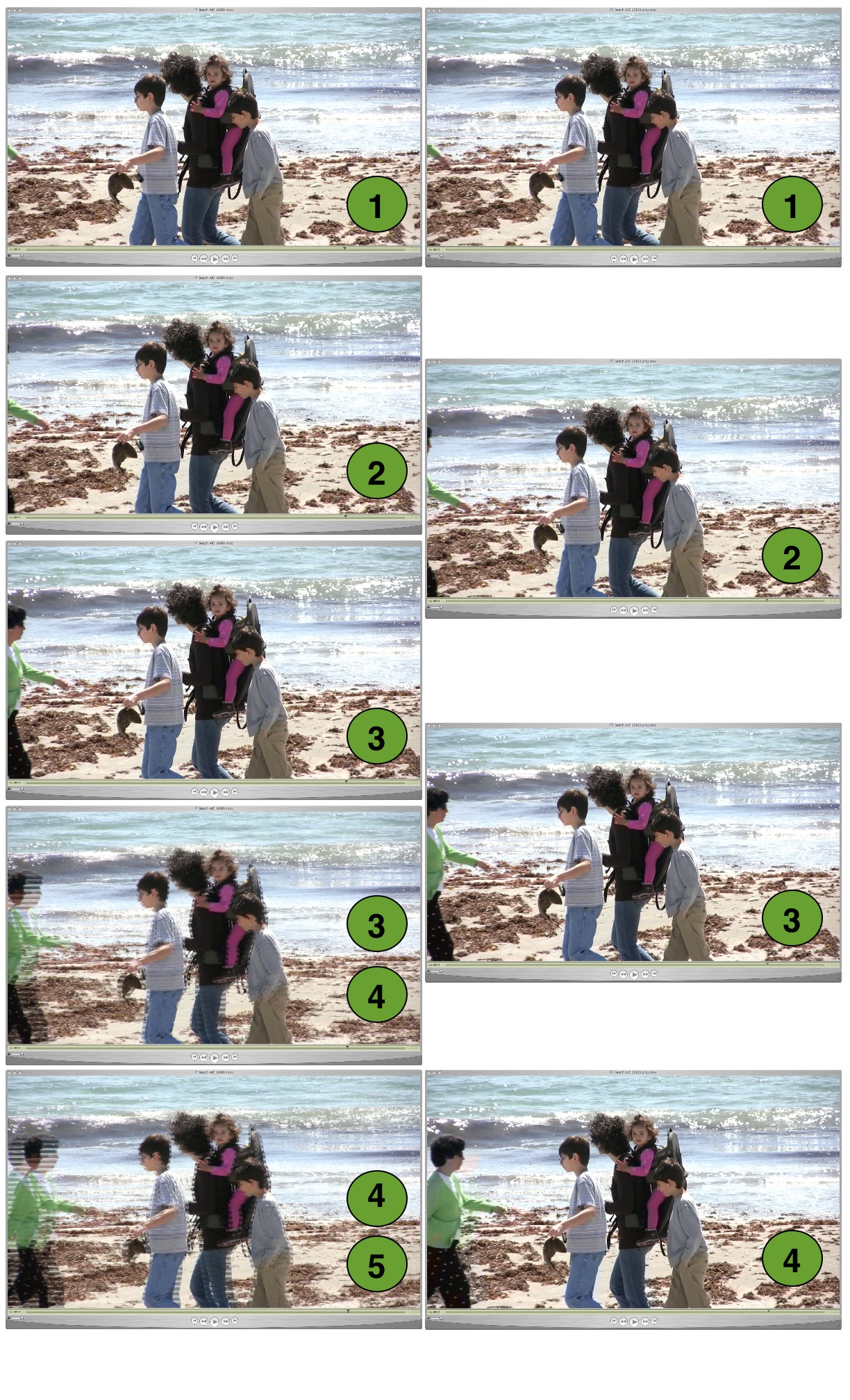

Sample File Comparing Before & After Reverse Telecine
I am not a professional and I take videos and make movies as a hobby but I found this thread very interesting so I decided to post a sample reverse telecine test I have done a few months ago using JES-Deinterlacer. At that time I was very interested in making 24p movies and downloaded the JES-Deinterlacer for that purpose. After some experimentation I decided that reverse telecine of an HDV file from HV20 is very time-consuming (at least for my purpose as a hobby) and since then switched to taking 60i videos and deinterlacing to 30p with another free software, MPEG-Streamclip.
To add to the above discussion, I believe HV20 does the 3:2 (or 2:3) pulldown in the manner it is described elsewhere on the web. (Just do a web-search using keywords 'telecine' or '3:2 pulldown'). This is very apparent when you deinterlace the HV20 video using JES-deinterlacer. You can see the 3:2 pattern when you compare the before and after clips. Attached is a sample jpg image I created after JES-deinterlacing one of my HV20 clips taken in 24p mode. Left column shows the frames from the original clip which shows 3 progressive frames followed by 2 pulleddown interlaced frames. In comparison, the right column shows 4 corresponding progressive frames extracted by JES-deinterlacer with reverse telecine option. I hope this helps.
P.

JPG Image Uploaded
Finally was able to upload the jpg image file.

Thanks Pedanes - I stand corrected.
Scott, I just ran HDV from a HV20 through QuickTime Pro and it frame dropped to 23.98 Pro-Res with terrible results. It looks as if it frame dropped interlaced video. So QuickTime Pro is not a viable option and as before, your footage must be processed:
