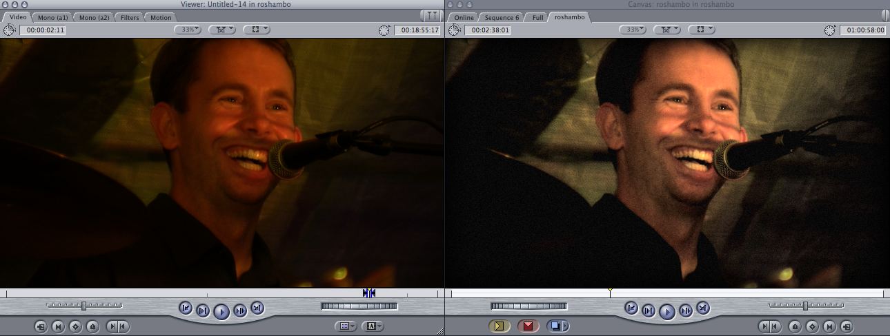

Hi Randy,
I shot this in a very dimly lit tent with an HV30.
~ R o S H a m B o ~
I intentionally added some grain and film effects to give it a gritty look. The audio recording was over-modulated so I ended up using an old recording from their myspace page. Below is what the original footage looked like before and after CC and film effects:
http://www.dvinfo.net//conf/attachme...1&d=1221880573
Its a wonderful little camera.
