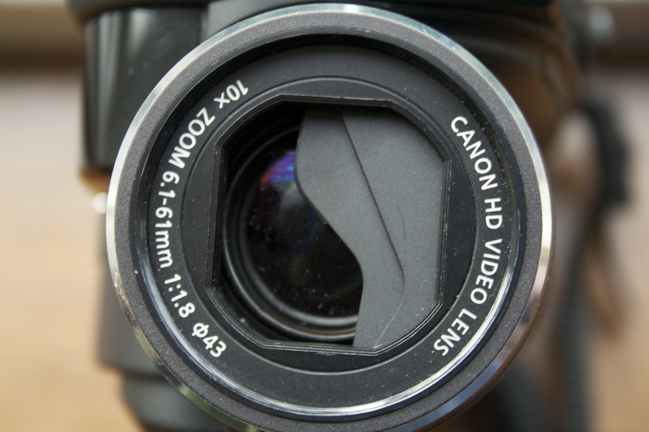

I just had a lens cover failure today on one of our HV30s. It's going to be inspected as a warranty repair, but as it is used in a school I had to reassure the vendor that it had not been dropped or abused. It was in use yesterday and seemed fine, though I didn't inspect it particularly carefully when I put it away in its case. This morning the cover wouldn't open fully when it was switched on. It buzzes but doesn't move when switched on.
HV30 Lens cover reliability?  Two failures so far :(-img_2389.jpg

Had another (temporary) problem with an HV-30 lens cover recently, but it went away after cleaning and massage. Probably caused by grit and looked much the same as the photo posted earlier, but it's working fine again for now.
I was more concerned about it not opening fully than about it not closing on one side.
