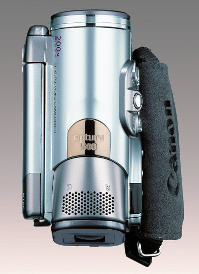

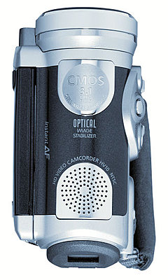

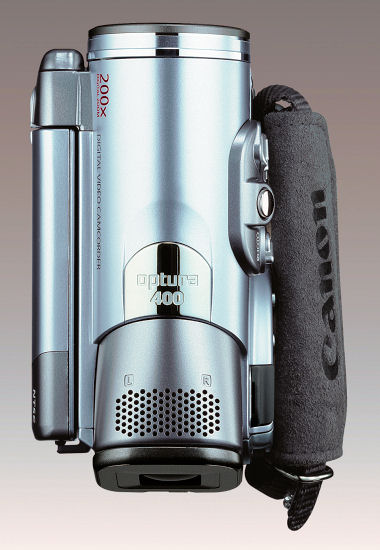

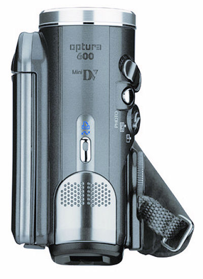

Speaking of mic placement, what does the HV10 have in common with every recent vertical Optura that came before it? See attached images. I didn't have a similar shot of the Optura 300, but it's the same thing.
A mic/reality check...-michv10.jpg   A mic/reality check...-micop600.jpg
A mic/reality check...-micop500.jpg   A mic/reality check...-micop400.jpg

As small as this thing is, where the mic is physically located isn't going to make any difference. No matter where you put it, most likely it'll still pick up some tape transport and zoom motor noise. If it was positioned on the front below the lens, it would be blocked by your fingers as you grip the camera. The location on top was the correct decision. Its position toward the rear won't affect its pickup pattern; the difference between a top front and top rear placement is less than two inches.
