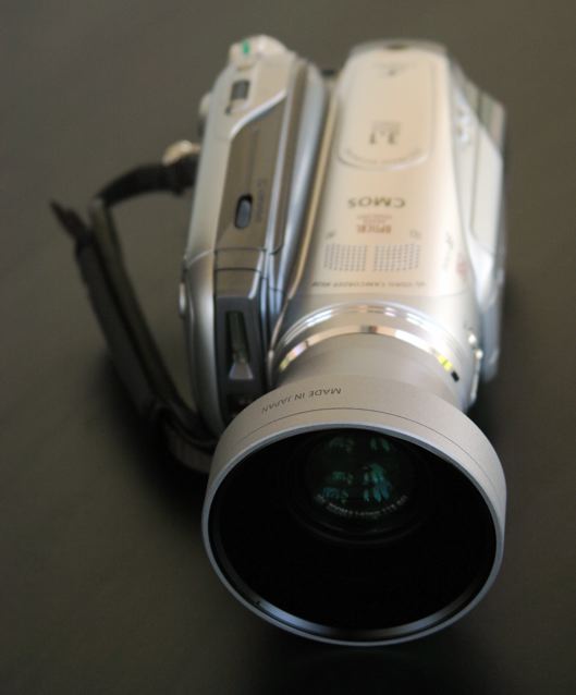

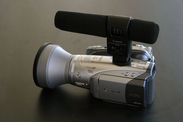

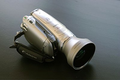

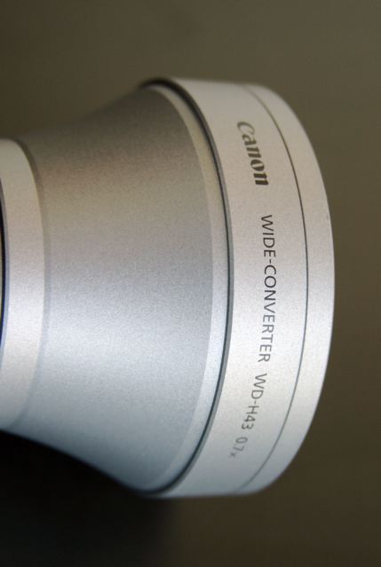

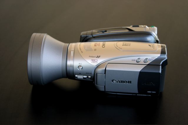

I had been asked to provide stills of the WD-H43. Here they are. The last one is the "well-dressed HV20" with H43 and DM-50 mike onboard.

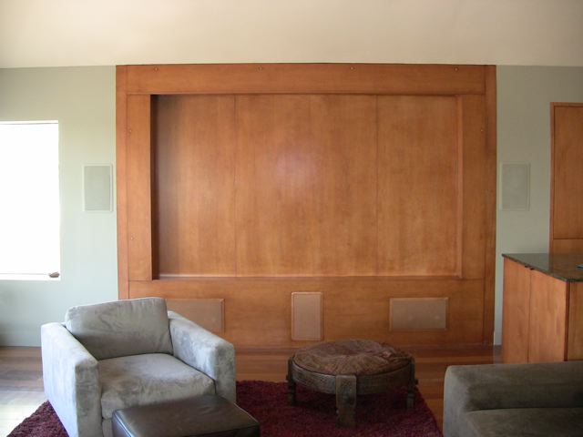

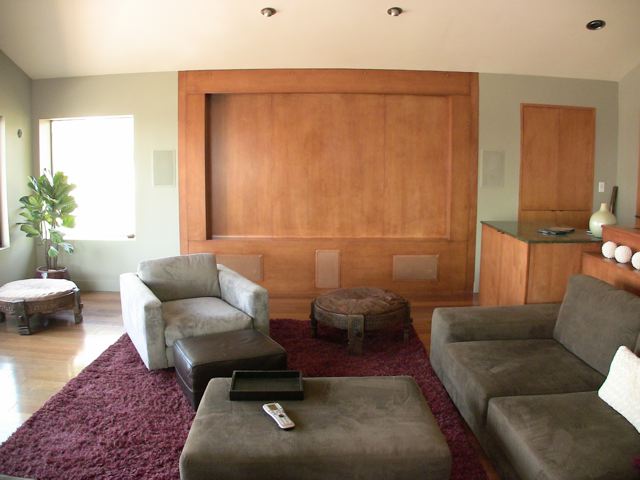

The last two are frames from the camera itself showing field of view with and without the adaptor. Clearly there is a bit of barrel distortion as to be expected with a wide angle adaptor (there's even a touch of it on the shot without the adaptor!)
The adaptor is quite heavy compared to the body, it adds up to a bit of a handful (you'll want to use two hands to operate). The center of gravity is pushed up to the somewhere around the manual focus button, i.e. a bit over an inch from the front of the camera!

Pretty impressive difference. Thanks Charles! This is exactly the shots I had hoped to see.

Am I correct in thinking that ceiling/wall line is straight in real life? Seems like quite a lot of "barrel distortion" offhand, bordering on fisheye. Nice field of view overall though!

Whats the best way to protect the large glass element at the front of the WD-H43? The photos don't seem to show filter threads!

Sure hope the ceiling is a straight line, we just remodeled last year!!
Yeah, that's a worst-case scenario that I put up, purposely so that you can see the amount of distortion. For most types of shots this won't be as noticeable of course. Wide angle adaptors tend to do this--I have compared the Canon adaptor for the A1 with the 6x wide zoom on the H1, and there is much more distortion with the adaptor.

Being careful is the best way to protect the adaptor! I suppose it would be possible to tape a good quality clear filter to the front (it would have to be a larger diameter to avoid vignetting) but consider that most pros forego filters to maintain the best optical quality and just take extra care; and that this is a "relatively" inexpensive adaptor to begin with so a calamity wouldn't be nearly as painful as, say, scratching the front element of the built-in lens.
In terms of the added mass, I am finding that using the left hand to support the camera from underneath with thumb and forefinger resting against the collar of the wide angle is pretty comfy, and relieves quite a bit of strain on the right hand (which has to work pretty hard to hold the camera level as all of the weight is offset to the left). This also frees up the index finger of the right hand to operate the zoom more comfortably. This works equally well with and without the adaptor onboard.

I just tested the field of view between the still function on the camera and the video side of things. The still side sees quite a bit more than you would get shooting video, thus the barrel distortion is not as pronounced for the video frame (and you will not see as wide an image) because it is not using the edges of the lens where distortion is more pronounced. Hope this helps!

The H and non-H versions are easily discernable by their appearance:
H: http://www.preistrend.de/img/picts/I189771.jpg (see also the photo's by Charles)
Non-H: http://216.25.78.123/pics/canon/7151a002.jpg
