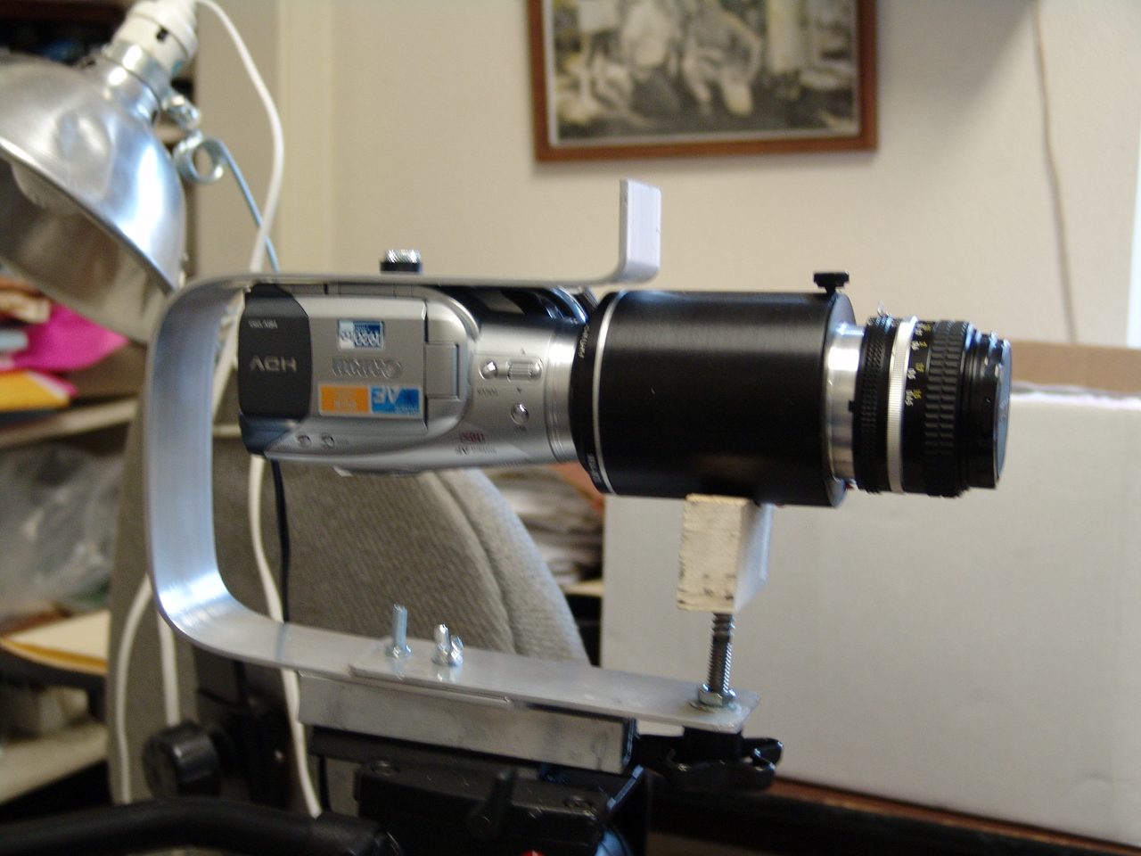

One of the reasons I got the HV20, is I thought it my be easy to construct a mount to turn it over, to shoot with an adapter. In doing so, you avoid the need to flip in edit.
I contructed a prototype from a $10 strip of aluminum, and $5 worth of other material, and came up with my first attempt which seems to worki out pretty good. See the photo below.
Expect to mount a monitor on top, and my Beachtek adapter on back.

What if you need to adjust camera settings?

Very easy access the way it is set up. Toggle is accessible, as well as menu button. Everything is on screen.

Chris, did you have to cut and bend that aluminum yourself or is there a shop that can do it for you?
Just brute force and ingnorance.
Got the aluminun strip at Home Depot. Its 2 inches by 3ft, I think. About 1/8 or less thick.
I just hand bent it, and cut as needed. the part on top was done in bench vice. the other bends were done by force against an edge. For instance on top of a table, with a portion hanging over. (I actually had a a divice I built for a "steady cam" that I slip this into to get a bending angle, but that was just a convenient tool....)
Note: I extended the bottom piece by bolting together two pieces after the fact. I had originally had another idea, and cut it too short. So my next version won't be two pieces on the bottom.
