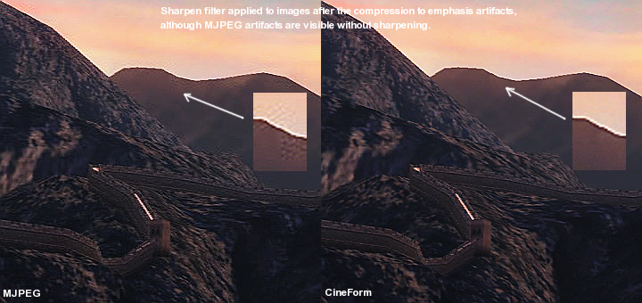

You wrote : "this should make everything nice and portable for shooting with the mjpeg compression."
be warned that the M-JPEG codecs in general have a lot of edge artifacts, therefore are not commonly used today in post unless very high data rate are used. Attached is a comparison but CineForm High quality and the Blackmagic MJPEG codec. Here is right up by another user that compared the to :
http://www.dvinfo.net/conf/showpost....56&postcount=1
Please make sure you allow user to select nicer codecs.
P.S. CineForm has pulldown extraction to 24p from the Intensity card as a feature of all our products.
yeah, i second that. use cineform. otherwise when i buy your box i'm just going to have to go through an extra step to convert it to that. :)
