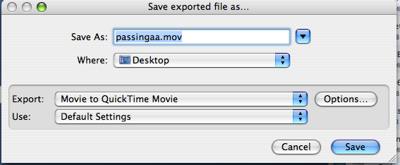

Regarding your question about "streaming", I believe you mean you want the movie to "Fast start". When you export you need to choose export " Movie to Quicktime Movie", then click the options. You'll see the choice for "Prepare for Internet Streaming" ~ Fast Start.
