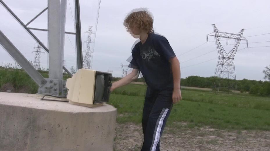

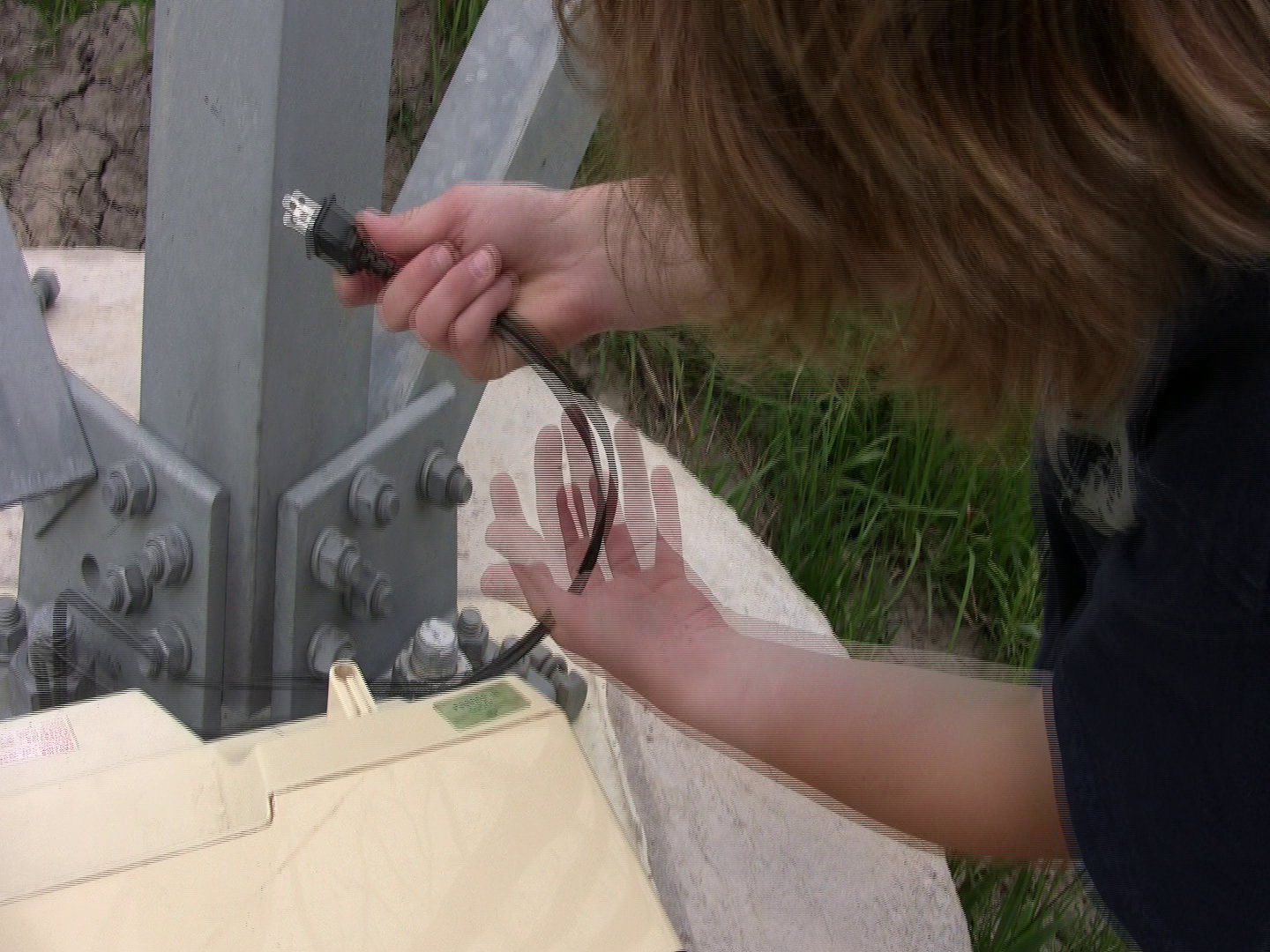

Location: Switzerland
Posts: 53
I think Jeremy's right. Especially concerning the pulldown. Like I said, your wmv file shows serious frame blending. You can litteraly see 2 frames overlapping each other (have a look at the still I grabbed). That's NOT what 24p is supposed to look like with this cam, BUT it will look like this unless pulldown is removed (NTSC owners, please correct me if I'm wrong). I guess if you want to achieve that look you're after you have to remove pulldown first.
I suggest the following: capture some 24p into your computer and, without further editing it, watch it with a player like PowerDVD or VLC. These players are capable of deinterlacing (you have to turn it on first), that is removing the pulldown 'on the fly' (worked for me with every single clip I downloaded here). If it still doesn't look right to you, it must be something else (maybe not shooting steady enough, like Jeremy said).
Enea Lanzarone is offline   Reply With Quote

- OK i took a "direct' screenshot from the original m2t capture, no rendering here at all involved.
heres is the raw screenshot, showing this blending i'm getting straight from my HV20 raw footage. is this why i'm getting that 'fast motion' music video style look to my footage.
Jay Cowley is offline   Reply With Quote
Does every frame look like that? With 24p only 2 out of every 5 frames should appear interlaced, no matter what the shutter speed.
Hal Snook is offline   Reply With Quote
Once again, It will NOT play back at 23.98 if you do not remove the pulldown. HDV will capture the footage at 60i and it will continue to be 'interlaced' like that until you remove it.
Did you capture it with HDV? If so, it was not 'raw' like you mentioned.
Try removing the pulldown and have a look at it again. There are plenty of threads on how to do that properly.
