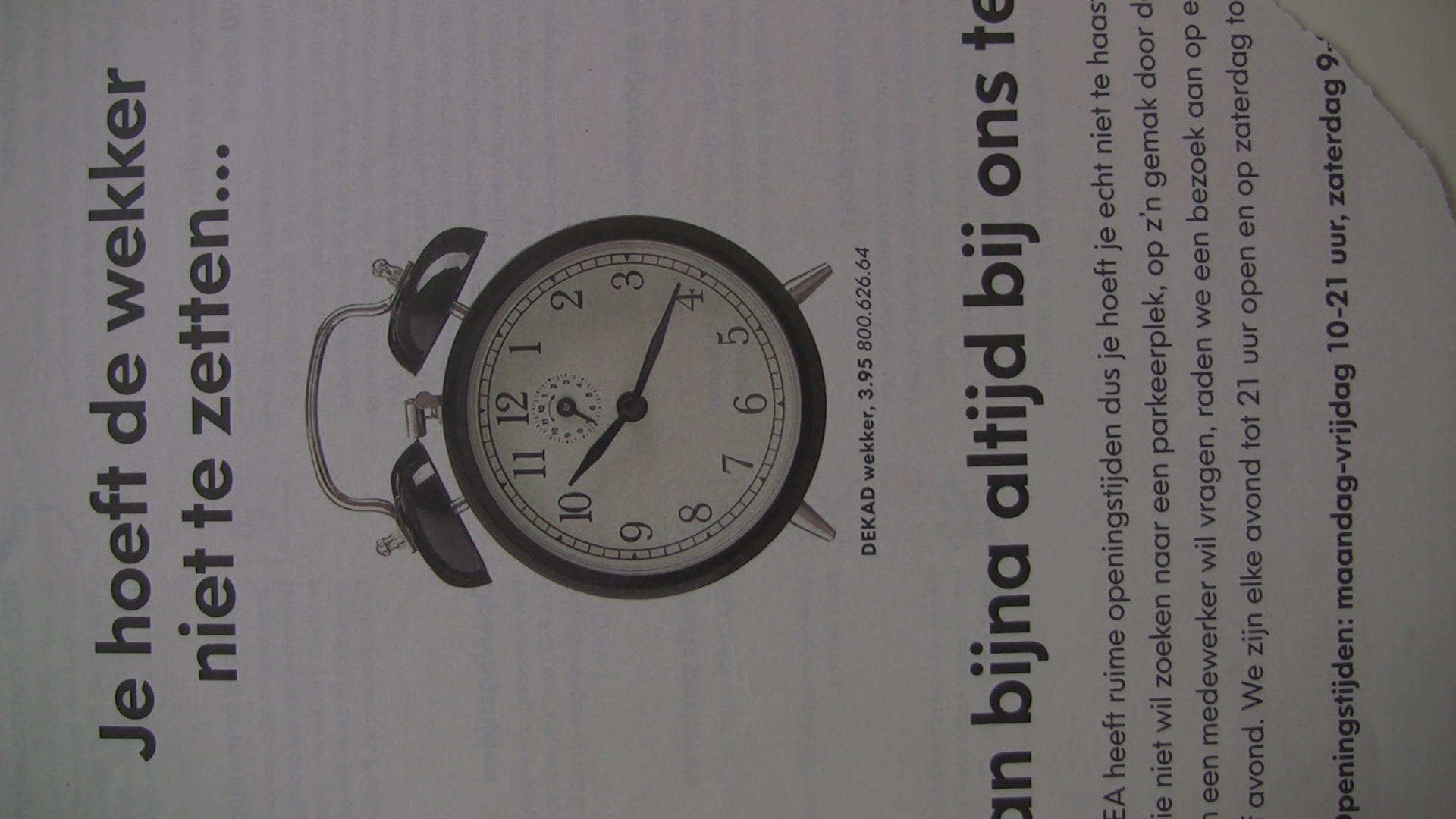

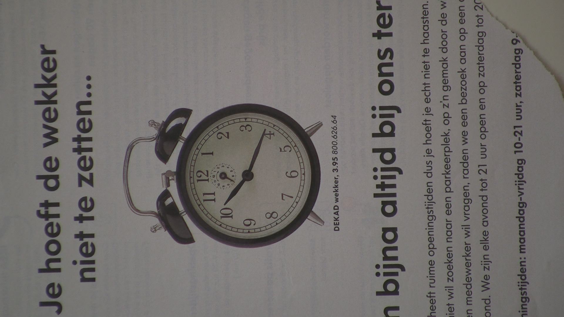

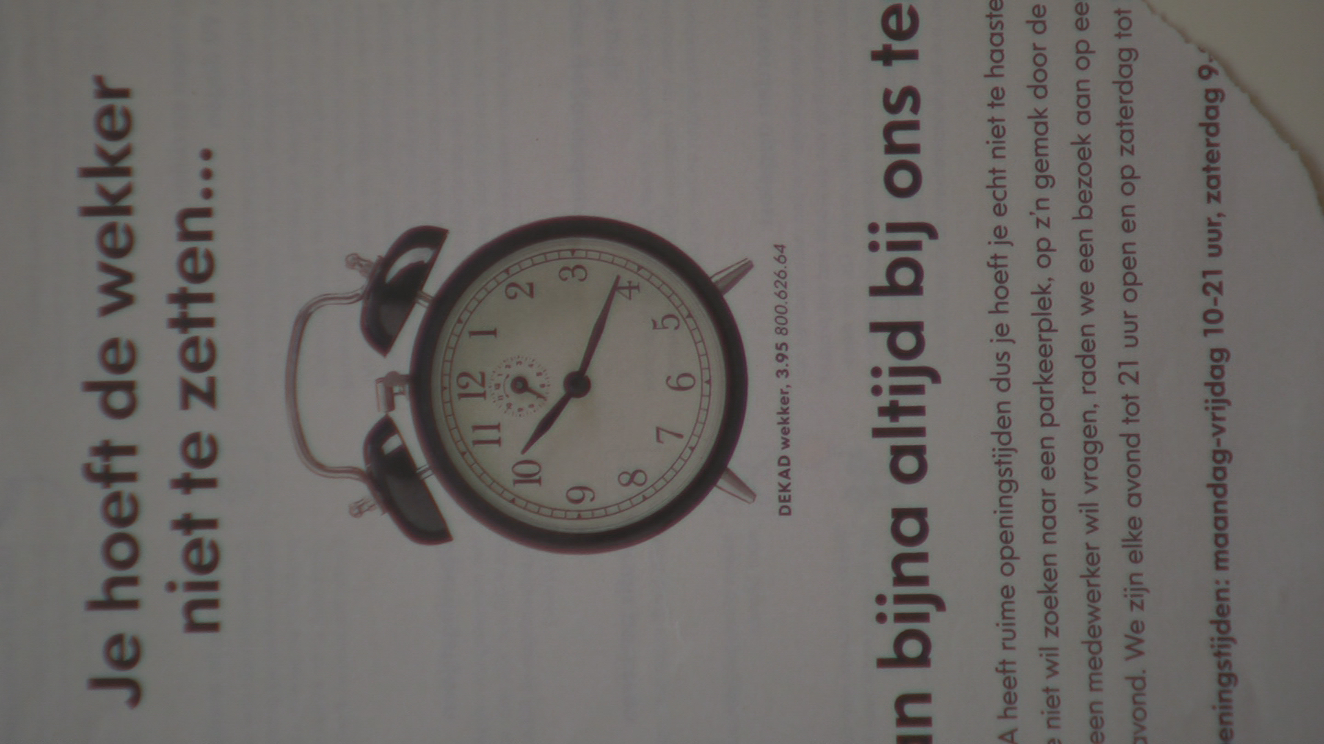

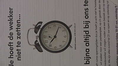

I have this old WD43 (not the H model) and wanted to know if it deteriorated the optical quality much. If not, this would save me a lot of money, obviously. Here's six JPEGs (100% quality):
- WD43, wide (zoomed out)
- WD43, med (zoomed in around half way)
- WD43, tele (zoomed in all the way)
- No WD43, wide (zoomed out)
- No WD43, med (zoomed in around half way)
- No WD43, tele (zoomed in all the way)
My conclusion, you may use the WD43 if you really need the wider angle, but it deteriorates the image a little bit. Zooming in a little actually helps, but that's not what you would use that lense for :). Whatever you do, stay well away from tele with the WD43: bad bad bad...
Next, the surprise (for me anyway): I did not like the "No WD43, tele" (ie the built-in lens zoomed in) very much, especially outside the center of the image.
Questions:
- anyone care to post some comparable tests with the WDH43?
- is the deterioration I experienced with my "No WD43, tele"-test normal for these or similar cams (such as the sonys)?
Thanks all,
Pieter

thank you very much for your examples. I think you didn't get too many replies, because your examples don't tell too much about the loss of quality.
The documents (IKEA? ;-) ) aren't filled with letters out to the corners, they are also just black and white. Flowers or any another colorful and fine structures that fill the picture 100% would probably be better.

the test as it was, was real useful -- but obviously color would be nice as well

Indeed some outdoor shots in good lighting would be great. I'd expect a slightly wider angle from an 0.7x lens, maybe it's just the object you're photographing that gives such an impression.

well it was a good test I think, first because its reproducable (still hoping someone does this through a WDH43 (just put your cam on auto and point at a printed piece of paper that's lit evenly)) and second because with this kind of material you can spot barrel distortion and blurring more easily (and third because I don't have a proper resolution chart ;). But there should have been more detail in the corners, so true.

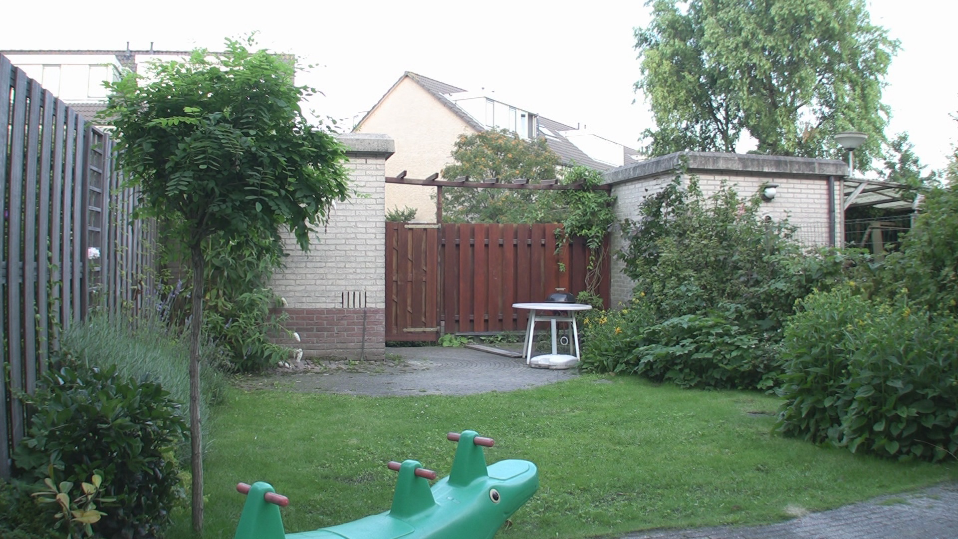

Anyway today I've shot some outdoor stuff. 4 JPEGs attached.
Scene1, shot this morning, WD43 and NO WD43 - A shot of our fence, especially for all the flower lovers out there. :)) Not too much flowers though, because by the fence you can tell the barrel distortion. Both shot in cinemode. WD43 shot taken from closer by in order to capture the same amount of fence, to be able to judge the deterioration better.
Scene2, shot half an hour ago (in twilight conditions, around 9PMCET, running full auto), again with and without the thing, but this time from same distance to subject, so anyone who's interested in the .7x effect can see what it does.
So i'm thinking I'll use it only when I really need the angle. But how cool would it be to be confident enough to go out and buy a better lens that I can keep on all the time because it hardly distorts or blurs! Again: samples anyone?
