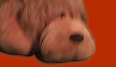

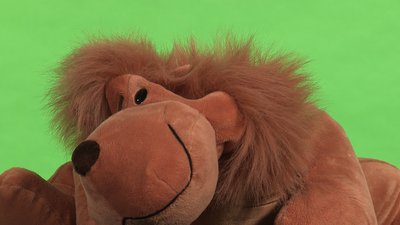

Green Screen frame grab - attached is a single frame export from an uncompressed capture out of the HD-SDI port into an MXO 2 into FCP - it's not showing up as a thumbnail, so be sure to click to download.
Additionally, here are 2 photoshop files containing frame exports of ProRes direct capture, and MXF (Mpeg-2) from CF card to ProRes. Included in the layers is a key I pulled using Keylight in After Effects.
http://www.holyzoo.com/content/XF305/ProRes5.psd.zip
http://www.holyzoo.com/content/XF305...tive_5.psd.zip
The bottom line is that I can't tell the difference between direct ProRes capture and Mpeg-2 to ProRes unless we're talking about lots of motion.
See the attached files showing the Mpeg blockiness in high motion areas. With all that said, for what most people end up doing with green screen, I think in-camera capture is more than good enough. However, if you're going to look at things under a microscope, find a way to capture to something better than Mpeg-2 directly.
XF305 Arrived - Test Footage, Trials, Tribulations-uncompressed.tif   XF305 Arrived - Test Footage, Trials, Tribulations-xf305_in-camera_mpeg-2_200percent.png
XF305 Arrived - Test Footage, Trials, Tribulations-xf305_straight_to_prores_200percent.png
