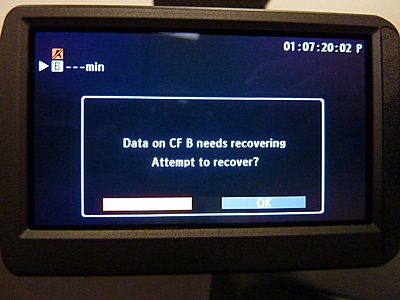

But the biggest issue I was having was consistent CF card write errors, and I pin pointed it to occurring about every 5 min. I tried multiple cards of the same kind - 32GB Lexar Professional 300x. A world of disappointment. Then I tried one of many Lexar 16GB 300x and its recording error-free all the way to the end of the card. Yee haw! Well there's 1 type of card that works. So I pop in a cheap Ridata 32GB 266x card and it just zipps along with no errors either. Well, so there it is - not all cards are going to work even if the speed is plenty up to the task. Firmware update? WTF.

How does your "consistent CF card write error" manifest itself? I'm imaging the camera stops recording and announces an error? Could I be getting write errors and not realize it?
All my work so far has been at 1920x1080 30P.
I am not discounting your write errors. I'm guessing there's a difference in usage that triggers the problem. Did you format your card(s) in-camera before use?
Brett, attached is a photo of the error off the XF305 display. It actually halts recording and you would certainly know it - its a straight up showstopper. This occurs after approx. 5min 12 seconds consistently on any of the 6 Lexar 32GB 300x cards I purchased in the last month. Might your cards be older and a different rev?
All cards tested - I had initialized them in-camera using the XF305 before use.
I also tested this in 30p instead of 24p and it makes no difference. So in short, if you're not getting that error screen and a halted recording, I guess your cards are working fine. I'm stumped on this one.
This exact thing happens to me with my Lexar Professional 300x cards as well. Something in those cards is not up to the task when the XF codec splits it's files at the 2gb point (about 5 min 12 sec in @ 50Mbps, at the approx 8 min mark @ 35Mbps, and at the 11 min mark @ 25Mbps). I switched to using 32GB Sandisk Extreme 60MB/s cards, and haven't had the error since. I also get the error on Patriot CF cards & Transcend CF cards that are supposedly within spec. My Sandisk & Ridata, however, do work without the error and can record continuously until the card is full. Hoodman CF cards also have no problem writing continuously, from what I've seen.
Brian, thanks for verifying this problem - although I wish this wasn't a problem! Your Lexar Pro 300x cards - are those 32GB or other? The 16GB cards I have are working fine. The 32GB are a no-go. Also thanks for some explanation behind why this is happening.
So caveat to others - don't buy your cards in advance assuming they'll work. The good news is that the 32GB cards work just fine with the 7D and 5D.

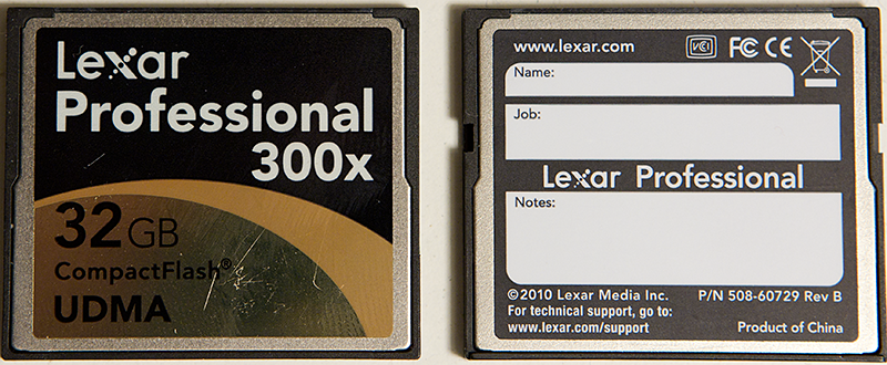

Thankfully, that's a new screen to me. And I hope to never see it.
Just pulled my cards out to look at them.
Data points for comparisons:
32GB CompactFlash(R)
UDMA
back: (C)2010 Lexar Media Inc. P/N508-60729 Rev B Product of China
(plus misc boxes to label cards in)
I wonder if the Rev B is relevant?
I purchased from a reputable regional retailer (Henrys) and Canadian memory webseller (memorydepot.com)
I've heard of fake memory in years past. At the price of these cards, I could see someone somewhere trying to fake a brand name... any chance of that?
(30 min pause)
Ok, I've decided to also post a photo - hope I gave it appropriate resolution.
Also, printed on the bottom edge of two of the CF cards (difficult to see) is
3215332GCSBC22106EA881 (card 1)
3215332GCSBC18106EA881 (card 2)
I have recorded concert-length clips (81 min / full card) as well as the more typical short (multi-second/minute) clips.
I hope this info might be helpful.
Brett
