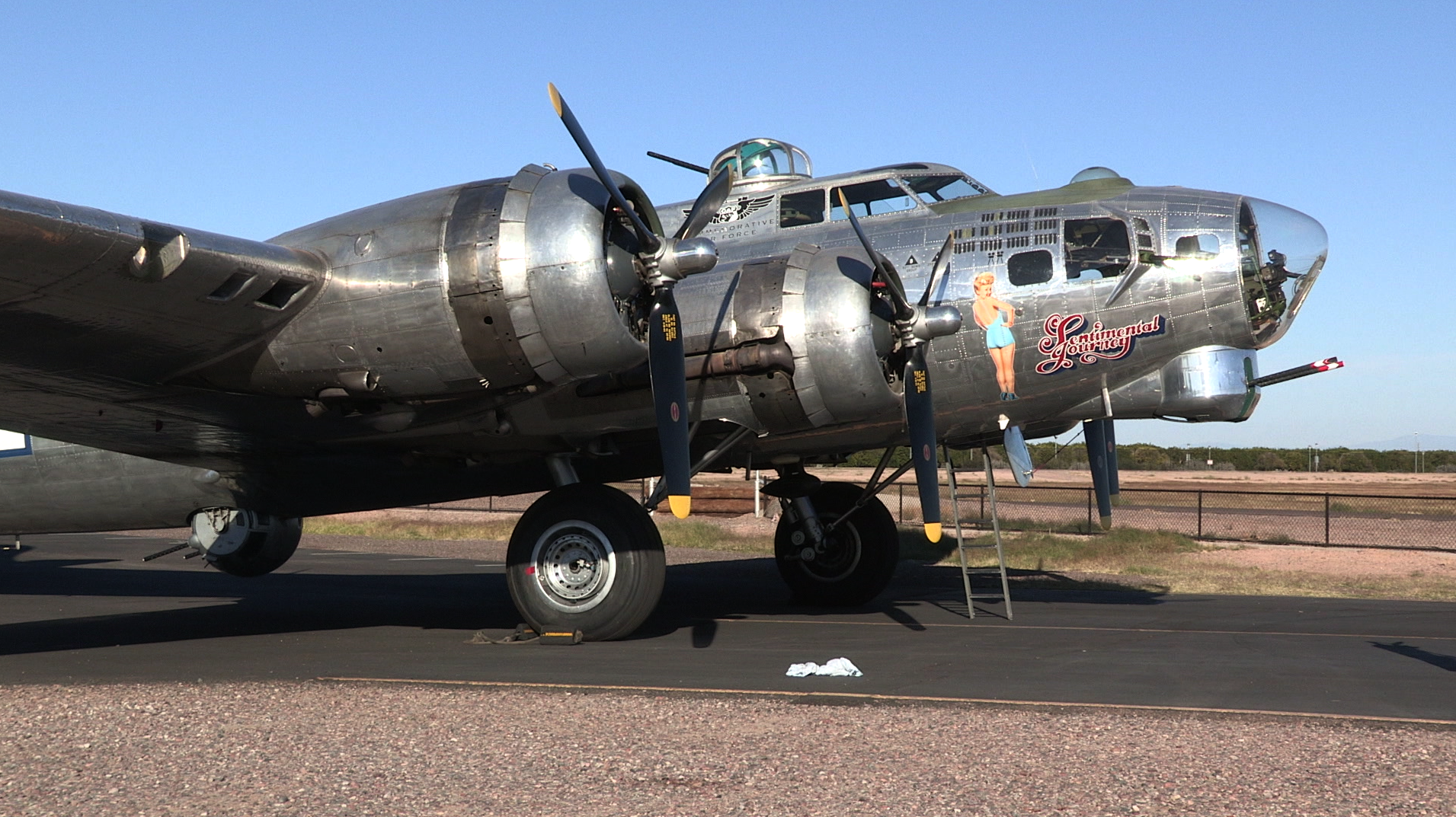

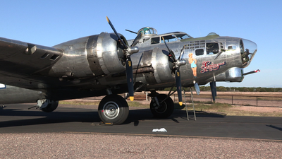

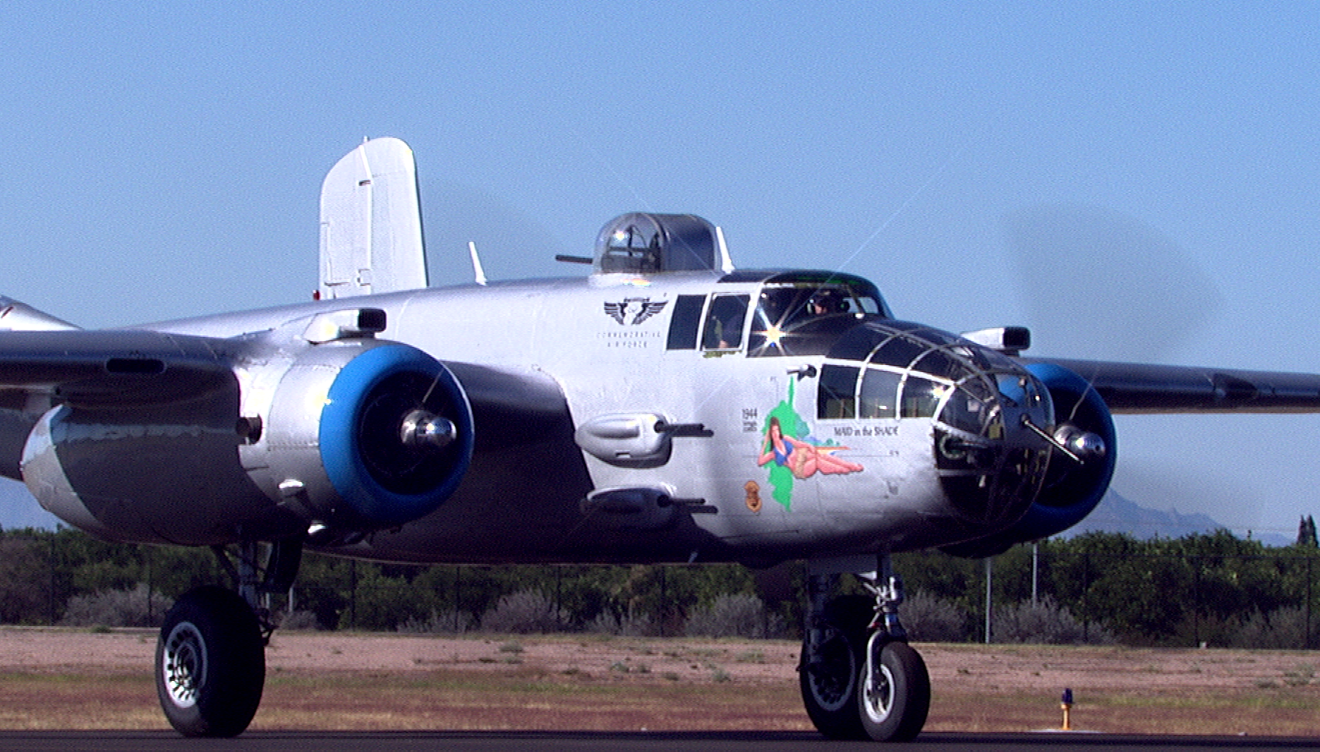

as I mentioned, I don't think they had the KiPro dialed in. I know the guys who own the system, I think I'm going to discuss this with them.
Here's a couple of screengrabs that pretty clearly show it. Wondering if some sort of noise is being introduced between the camera and Ki Pro?
And I know there's no way the XF is a better camera! Just calling this one like I see it!

Wow, are you sure #2 wasn't shot with a 1990 era VHS camcorder?
They've got more problems that just not "dialing in" the right settings. I really don't know how you could get a HDC-1500 to look that bad. I'd be embarrassed.

If they were recording 100mb/s with the Ki Pro they were doing themselves a great disservice. The Ki Pro goes up to 220mb/s at 30p.

I can't see how the Ki Pro could be the problem. My F800 looks fantastic at 50Mbps 30P when recording to XDCAM optical. I could barely see any difference at higher bit rates when I tested the F800 with my NanoFlash. For green screen work, sure there's a little difference, but for outdoor daytime shooting you'd really have troulble telling 50 vs 100 or 220. Same thing goes for my XF305. Recording at higher bit rates than what you can get on the CF cards directly has very little benefit for routine shooting
The problems that freeze frame #2 show go way beyond any recording device problems. The camera itself could not have been setup properly. The bit rate is not the issue. Just to prove me point, here's some aircraft footage I shot last year at only 35Mps with an EX3. And what you're seeing on Vimeo doesn't look anywhere near as good as the original (no grading has been done).

Yeah...not sure what's going on. The sr1 footage looks perfect so it's something they did getting it to the KiPro. I'll be going over this with them and this was a test run for a few things in their rig...not a paying client.

My guess, which could be way off base, is that the aperture on the Sony was set way too small, causing diffraction and gain. Just a wild a$$ guess.
