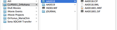

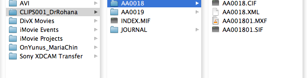

What exactly do you have sitting on your HDD right this minute? What files & folders and how are they nested? Hopefully you're not just staring at a bunch of loose MXF files.
Old December 2nd, 2010, 12:51 AM   #5
Location: Malaysia
Posts: 91
Ah! Now that's a tip! Thank you!
Errr ... at the moment my folder looks like this:
encoding .mxf to .mov with XDCam transfer-screen-shot-2010-12-02-2.44.30-pm.png
