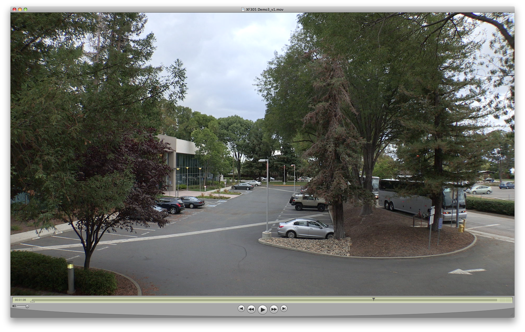

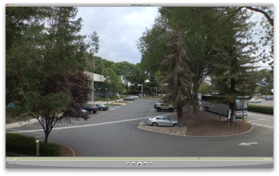

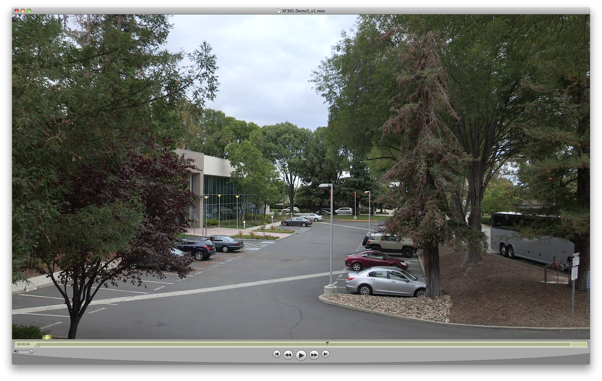

At 1:20, I briefly test out the wide angle adapter in this video:
In addition here's are screengrabs of a shot without and with the adapter. On the edges the image gets a little soft and some chromatic aberration appears.
I'll be expecting a good wide angle on the Panasonic AF100 to blow this away.
