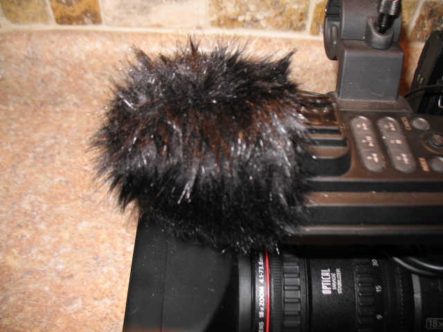

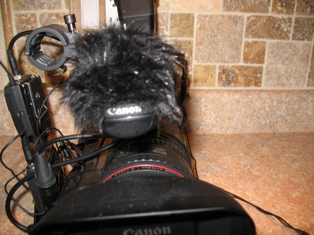

Well I fixed my problem and only spent about $5.00.
I will attach some pictures to show what I used and how I did it. Later I will post the whole process on youtube. It was pretty easy and took about 30 minutes.

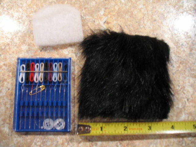

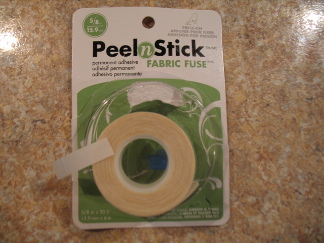

First I went to a local fabric shop, and when I told them how much I needed (less than a 4" square, the lady just cut me a "sample" piece. She also gave me a sample of quilting batting) I then purchased some Peel n Stick fabric fuse (used for hemming up seams) and some black thread and needles.

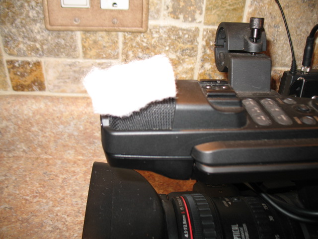

1. Cut a piece of the batting so it would fit over the mic ONLY (do not let it go past the mesh of the mic, you'll see why later), then cut a strip of fuse tape narrow enough to fit on the center bar of the mic, then place the fuse tape on the center bar and remove the paper cover. Next center the batting on the tape and press it down completely.
2. Take the 3 1/2 X 3 1/2 piece of fur and make sure it fits from the front Canon logo to the cold shoe, then make sure it fits from the left side to the right side (I opened up the LED screen to make sure I didn't go to low) Remember, it's ok if it's not completely tight, just be sure you have enough material.

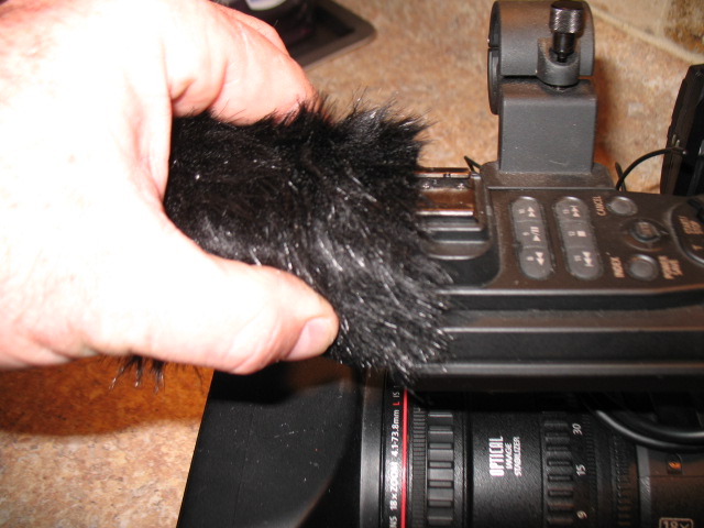

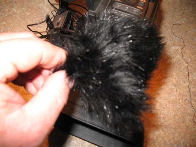

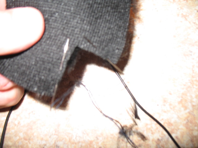

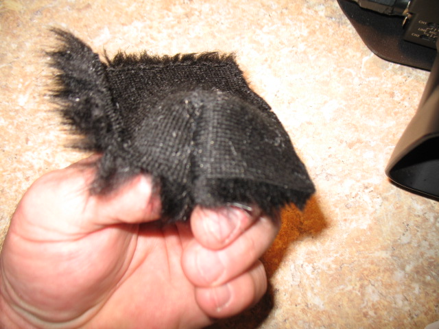

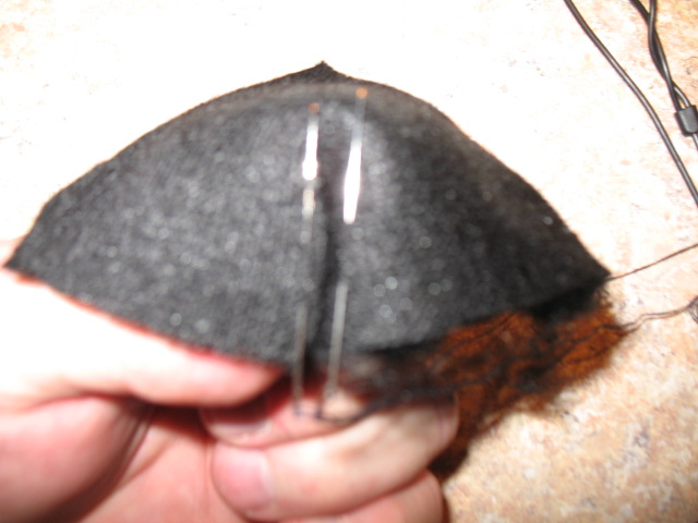

3. Now come the fun parts. Making sure you are still back to the cold shoe slide your fingers forward to the front then find the corner and move your thumb to the side and pinch the fur at the corner (see picture). Keeping it pinched remove it from the camera and turn it inside out so you see the join you just made. Next I used 2 needles to mark the joint (see picture) then cut along the 2 needles. Make sure your edge matches up (see picture)
4. Stitch up the joint you just cut and then do the same on the other side.
5. Cut strips of the Fabric Fuse and place it on the camera all around the mic mesh. (I used a full wide strip in front of the cold shoe but cut the strip in half on the sides, and I did not cover the tally light or remove sensor with tape) Now apply your fur cover and press it down and you are finished!
One of the reasons I used the Fabric Fuse tape is because when I want to remove the cover that tape can be removed by just rubbing your thumb over it and it rolls right off.
I hope this helps someone as well as it's helped me... take care!
