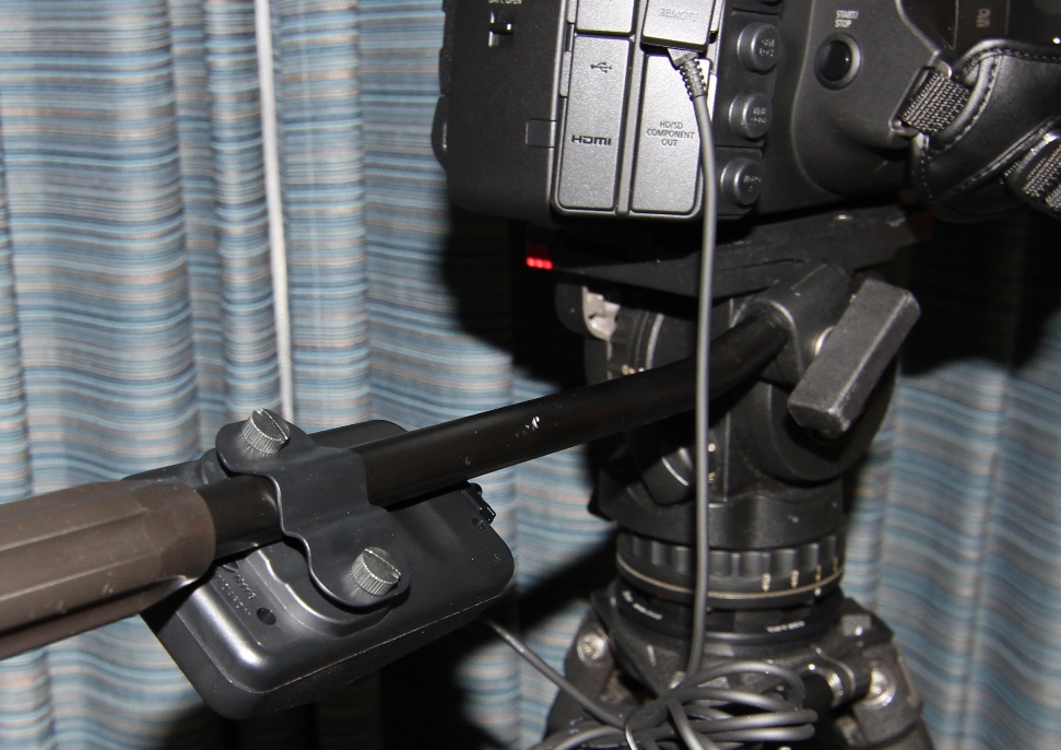

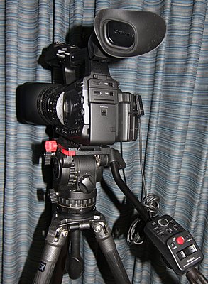

Received the XF305 today! The ZR-2000 LANC Remote Controller works as advertised. I can manually control the iris. It's lightweight and easily attaches to the panning arm. Plugged it into my XL-H1A and after making the setting adjustment in the Custom Function menu, confirmed that it will also permit manual iris control on that camera as well. Checked the manuals on a few other cameras and found that this iris control function will work on the XH-G1S and XH-A1S, but not on XL1, XL2, XL-H1, XH-G1 nor the XH-A1.
So far I've watched all the Vortec Media DVDs and shot a few practice clips, downloaded the cards (SanDisk 64GB Extreme Pro 600X UDMA7) to the Nexto DI storage device and also directly from camera to laptop with Canon Utility program. Opened right up in Sony Vegas and did some minor edits to see how that goes. So far, so good.
Mark

Just to clarify- the XL-H1 a and s models will also do this. It is Custom Function 17.
