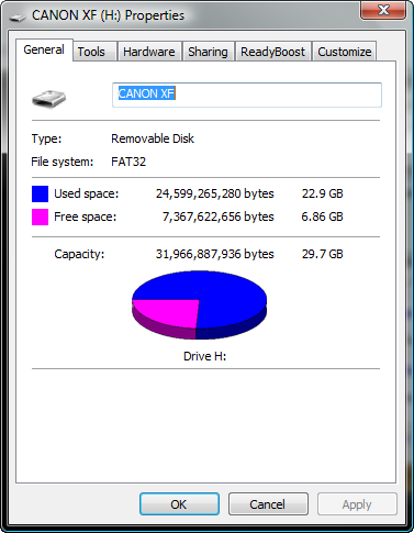

I just noticed something strange with my XF300 and wonder is this is normal, or some firmware error.
I have a 32 GB CF card in the camera. The camera indicates only 2 minutes of recording time left on this card. So, one would think the card is pretty full, right?
Well, it is not. See the picture below. Only 22.9 GB used and 6.86 GB free. Why does the camera indicate only 2 minutes remaining recording time? IMO it should be much more.
Any thoughts on this?

If you are recording at 50MBPS at 1080P, your full recording time should be around 80 mins...How much have you recorded so far?

1:02 when it switches to the next card, so 62 minutes and the free space on the card is still 6.21 GB.
Recording at 1080i/25 fps 50 MB/s.

What CF card are you using? Canon recommends specific brands to be used with this camera...

SanDisk Extreme 32 GB

Try to record until the camera stops the recording...Then see how much space is left on the card.

After it says END, there is still 6.21 GB free.

Reformat the card and record till full again and see if it actually fills up. I would say that is not normal - but I've never check to see how much space I have on a card... only how much time.

I see similar issues on the XF100 sometimes. (Sandisk 32GB)
I have also seen 32GB Sandisk cards formatted in the Canon C300 and when they are formatted only 8GB can be used on the card. The Sandisk card somewhat "offended" the C300 since it formatted correctly in a Canon 5DMKIII.
So there seems to be something with the Canon cameras internal software that does this. Are you on the latest firmware for the camera?

I have seen this also with the xf100 and 32 gig Transcend cards.

I just updated the firmware to version 1.04. I had 1.02 up to now.
I will initialize a new card and see where it leaves me. I'll let you know.
