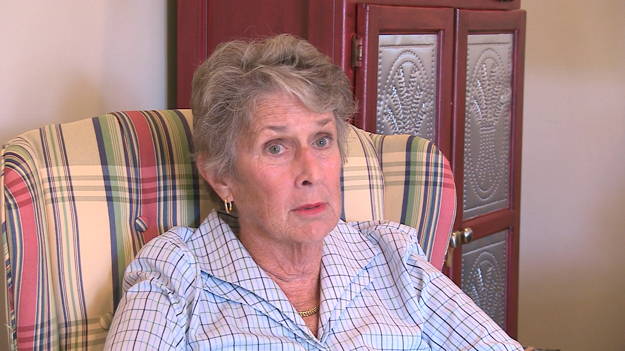

You'll notice I did not call what I do "color grading" :-)
I just use the scopes, etc. in FCPX and use either the built-in tools or a third party plugin to set shadows, highlights, and mid tones where I want them. I can do color correction, add saturation, and sharpness if needed. I can also use the color mask and shape mask tools in FCPX to do basic color tweaking of specific areas, but find this is rarely needed.
It's not rocket science, but I find it suits my working style well.
The 4:2:2 color in these cameras really allows a lot of freedom in post - if you want to shoot baked in, you can, but it definitely does not have to be. These screen captures are slightly softer than the original - had to convert to jpeg to get them to upload here. Shot at 720p, so view them larger to see better - left is out-of-camera, right is after post work.
Finally, Color and CP success with XF300-brflat.jpg   Finally, Color and CP success with XF300-brgraded.jpg
Last edited by David Dixon; November 19th, 2014 at 02:12 PM. Reason: added screen shots
David Dixon is offline   Reply With Quote
