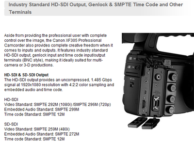

I am trying to record from HDMI and HD-SDI of the XF305 while in 24p mode but it is always in a 2:3 pulldown as 60i. I can't find the menu item to switch to true progressive output. Does anyone else have a suggestion?

As I understand it, there are no options for progressive output at full HD on the camera, just 60i like you are seeing. The SMPTE 292M is capable of it, but it's not implemented in this camera. I don't know if someone (AJA, Matrox, BMD, etc.) makes a box that will convert in real time to what you want.
Canon U.S.A. : Professional Imaging Products : XF305
Mark

The consumer/prosumer cameras all seem to ONLY output 1080i as the norm, and it has been that way since the HDV days. Many monitors cannot handle 24p or 30p natively, so the camera makers have standardized all output to 1080i over the HDMI port. There is typically no menu setting to change that.
What are you using to record the HDMI output? The Atomos Ninja 2 can remove the pulldown and record the true 23.976 signal to hard disk as ProRes.
