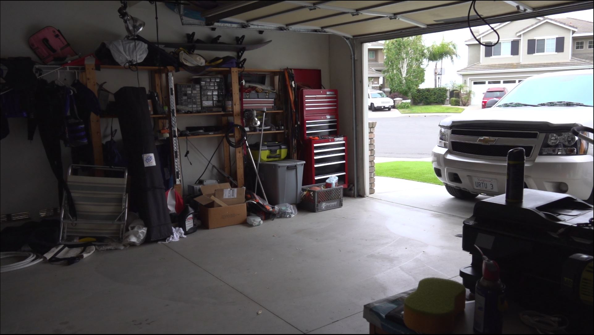

I saw the problems viewing on my computer (VLC, Premiere pro, my 55" Plasma TV) No grading, no effects applied, just straight out of the camera. I understand your thoughts. I viewed all the clips a 1:1 zoom ratio's to make sure there was no scaling. I shot with and without Clear Image Zoom, Digital Extender etc. Look at the Black Drawers on the tool box. They "shimmer" when the clip is played.
I have posted short clip (few seconds) so you could see it for yourself. Look at the Black Drawers on the tool box. They "shimmer" when the clip is played.
Here is the link: https://drive.google.com/drive/folde...c7?usp=sharing Download the clip. It is an unedited clip trimmed with Avidemux so no processing was done to the clip.
I also have a Sony A7Sii. I shoot 1080p only in Super35 mode since if I shoot 1080p from the full sensor, I get the same issue I am seeing with the Z90/NX80
Attached is a 1:1 Frame Grab
