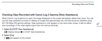

Anyone have any luck getting 100% zebras to work? I'm not sure how I'm suppose to shoot with CLog3 if I can't see what's clipping...

Just as an FYI, in case anyone else has this problem, I discovered that you have to turn the View Assist feature on, when in CLog3, for the 100% zebras to work properly.

That's interesting - the User Manual states that View Assist displays an image on screen that 'approximates to the one that would be obtained using BT.709 Wide DR gamma settings' (see attachment).
In the absence of a WFM, and for run-&-gun, I guess that's the best you can hope for.
Presumably Canon assume that people would use an external WFM for setting exposure when shooting CLog3 under controlled lighting conditions.
