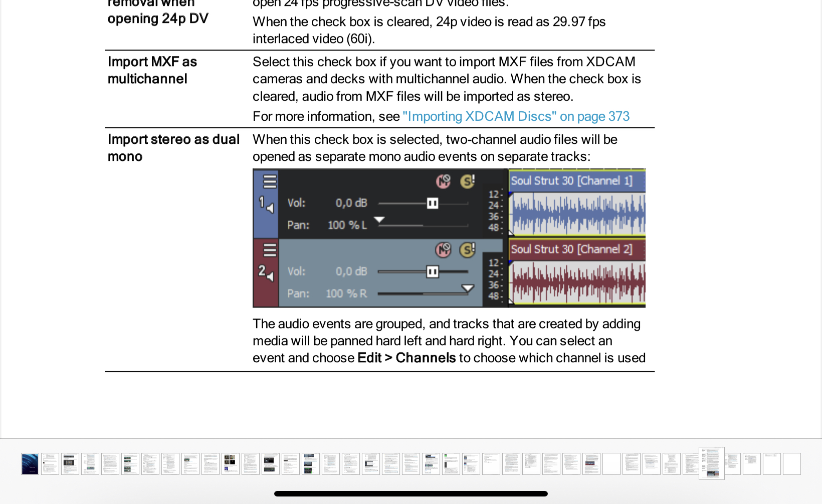

I'm using a XF200 and for the first time yesterday I decided to try 4 channel audio recording, with 1 external mic. I was hoping to obtain one stereo track and a mono track. When I take the clips into Vegas Pro I see only 2 tracks although the clip properties state 4 channels. Were my hopes beyond expectation?

Hiyah! There’s an option in Preferences to allow importing Multi Audio Channels. See my attachment. Give it a whirl.

Thanks Graham. That's worked. Now I know what to do in nthe future.

You’re welcome. If you haven’t done so far, do download the VegasPro Users Manual. I got the above from VP18 Manual. 600 pages of valuable reference and research.
