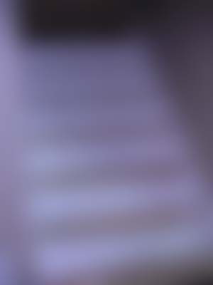

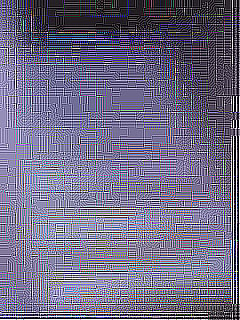

Or just have a strong drink or a beer too many. Results may vary, but what you will see may also be similar to 33 bit... whatever :)
Bogdan Tyburczy is offline   Reply With Quote
Old September 18th, 2007, 10:46 PM   #35
Location: Brooklyn
Posts: 161
... and just want to add that 33 bit algorithm is perfectly reversible with proper sharpening, as seen in attached example ;-)
