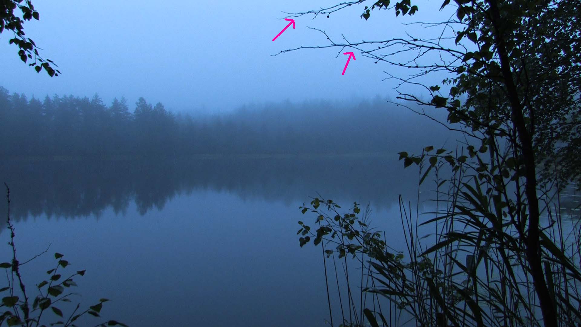

I haven't used much 25F until now and here's a question about it. I get quite bad stairs in thin lines, as if 25F was interlaced (showing only another field). This happens only when a thin object is in front of bright background. But I haven't ever seen this with 50i. So am I capturing my 25F-material wrong or is this normal behavior with F-mode? I use FCP6 (HDV-1080p25 settings) to capture/edit.
Click the picture to enlarge it:

Old September 10th, 2007, 02:20 PM   #2
Location: Guarda, Portugal
Posts: 119
Same here...
I have exactly the same problem, and it gets worst when you downsize it. Sometimes i use the Flicker filter to hide it a little.
Luis Rolo is offline   Reply With Quote
Old September 10th, 2007, 02:34 PM   #3
Location: Girard, Ohio
Posts: 103
I read an article stating that Canon produces it's frame mode by using a vertical pixel shift; this is because the image sensor is interlaced, and they are not able to give us true progressive. This may explain why you see the effects you are talking about. This also reduces the vertical resolution when compared to the interlaced frames. They are approximating a progressive scan.

Old September 11th, 2007, 02:39 AM   #6
Location: Helsinki, Finland
Posts: 393
It looks like it has been deinterlaced. What capture/editing software settings are you using? Do you happen to use FCP 6 with "no fields" in the settings? If so it is possible that it's deinterlacing the image.
Mikko Lopponen is offline   Reply With Quote
Old September 11th, 2007, 05:01 AM   #7
Location: Finland
Posts: 77
I'm using:
HDV 1080p25 preset to capture
HDV 1080p25 (HD 1440x1080 / Field Dominance None) for a timeline.
The problem is that I can only see 'stairs' when objects are in front of a bright background. There are limited situations where stairs appears. Otherwise picture is good.

Old September 11th, 2007, 08:03 AM   #8
Location: United Kingdom
Posts: 451
It has to do with the way Canon creates progressive frames from an interlaced ccd. The sampling means that alternate lines have 1/3 of colour information to build the picture from hence the stair stepping.
You'll only notice it on high contrast areas and has absolutely nothing to do with capture settings.

Old September 13th, 2007, 01:17 AM   #12
Location: Finland
Posts: 77
Try setting field dominance to upper. I know it makes no sense, but FCP 6 WILL DEINTERLACE video material if field dominance is set to none. Then take another screen capture and show us the result. ...
I'm not a FCP guru, but isn't it impossible to choose upper field for capturing 25p(F) material via firewire? I think FCP forces you to 'none' field order if the preset is set 1080p25.
I tried to set upper field after capture, but it didn't change anything. Also it seems that stairs are already in the tape, though I can only check this via component out which forces me to use 1080i.
Are you sure about that "FCP6 will deinterlace", because the picture doesn't normally look like that. I'm quite sure that my captured material is 25p without any interlacing.
I have witness this stair effect in very few shots, so this could be the reason why you haven't seen this.
Still I'm wondering has anyone with NTSC 24F -version seen this happen?
Poppe Johansson is offline   Reply With Quote
Old September 13th, 2007, 02:24 AM   #13
Posts: 393
I had a 960x720 DVCPRO HD sequence and FCP deinterlaced it if field sequence was set to none. After capture, it doesn't do anything to the during capture. Maybe your FCP understands that those XH A1 files are progressive, but my FCP didn't understand my P2 files.
Did you export an image and look at it? The preview window also deinterlaces if it's smaller than 100%. You could also try opening the files with quicktime and take a look at the direct stream.
That's because 1440x540 is still enough resolution that you won't see those stairs everywhere. But they are there, just simpler to spot with high contrast edges.
Old September 13th, 2007, 02:57 AM   #14
Location: Finland
Posts: 77
I've done all that. Only step where deinterlacing could happen is capture, but I can't change those settings (1080p25 is field none like it should be). I can view material in Full HD scale (FCP and QuicktimePlayer), so what I see should be ok.
Here's the original clip you can download. It's very foggy shot with low light, but the 'stair effect' is really visible. Captured with 1080p25 preset.
Download clip here (25Mb):
http://aavekammari.pp.fi/stairs.mov
