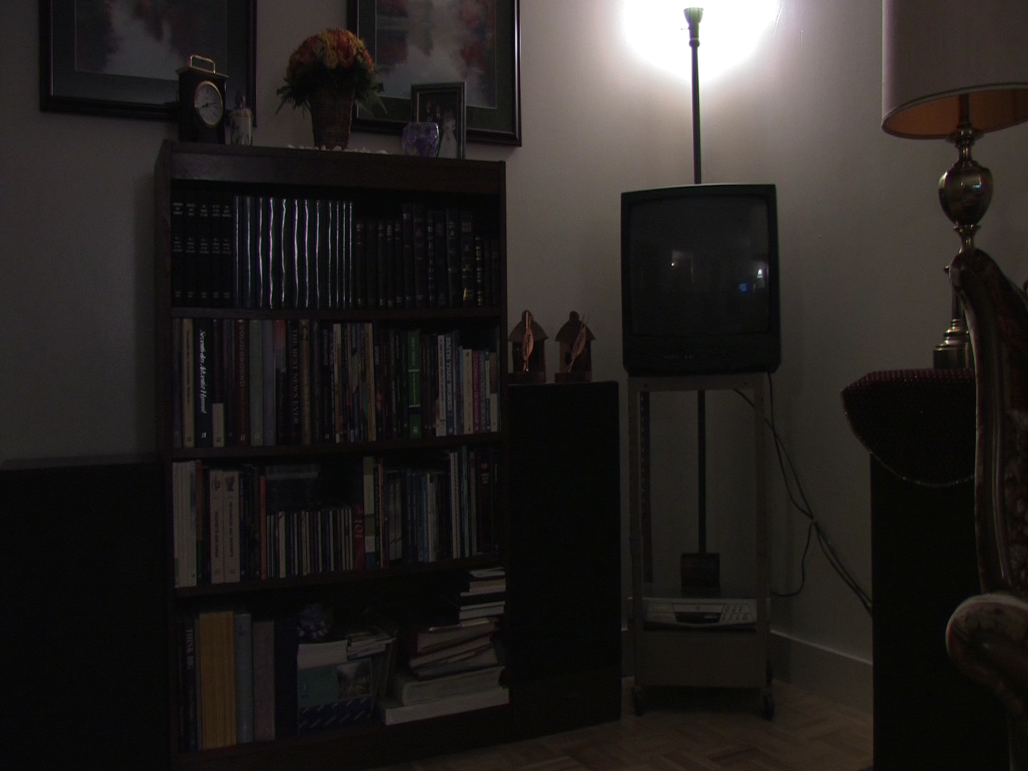

Here are the GL-2 screengrab as requested
This is not a great picture I'm just using it to demonstrate the light variance coming in to both camera.
Settings are TV 60/exposure lock on/scroll wheel steady and neutral at a +0 setting.
Now,I'll try to get the A1 to upload.

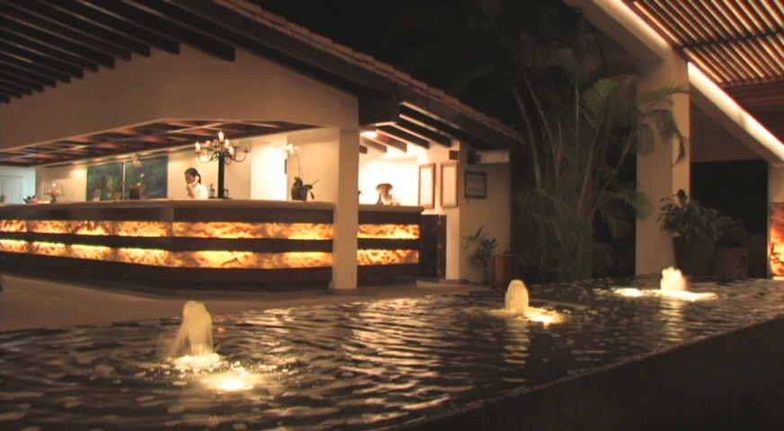

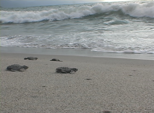

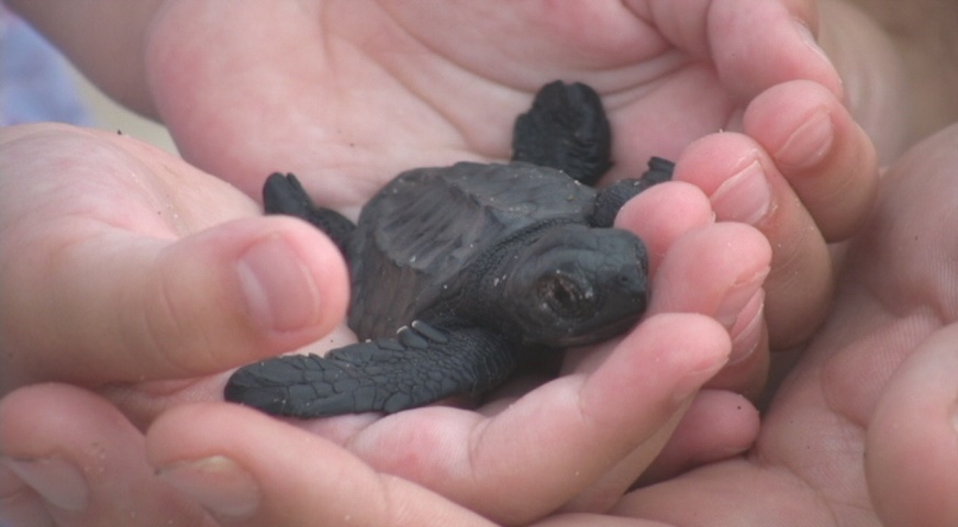

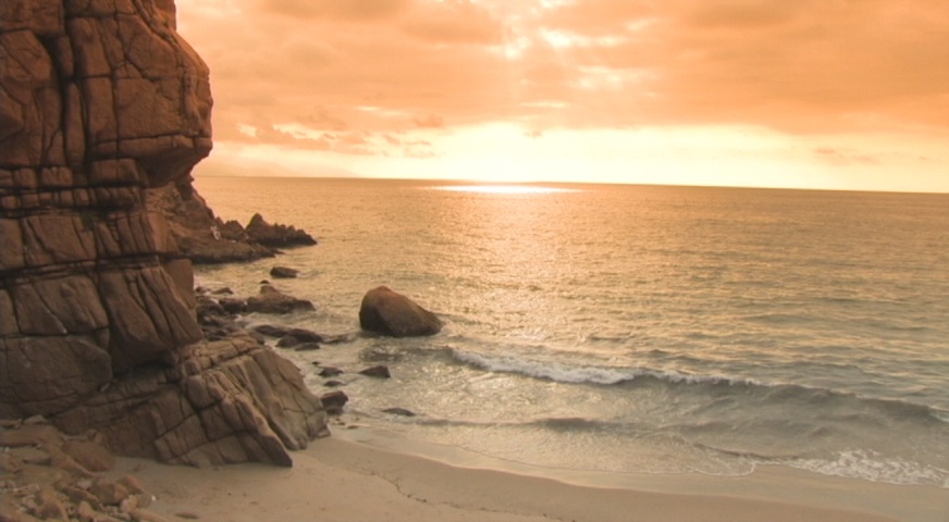

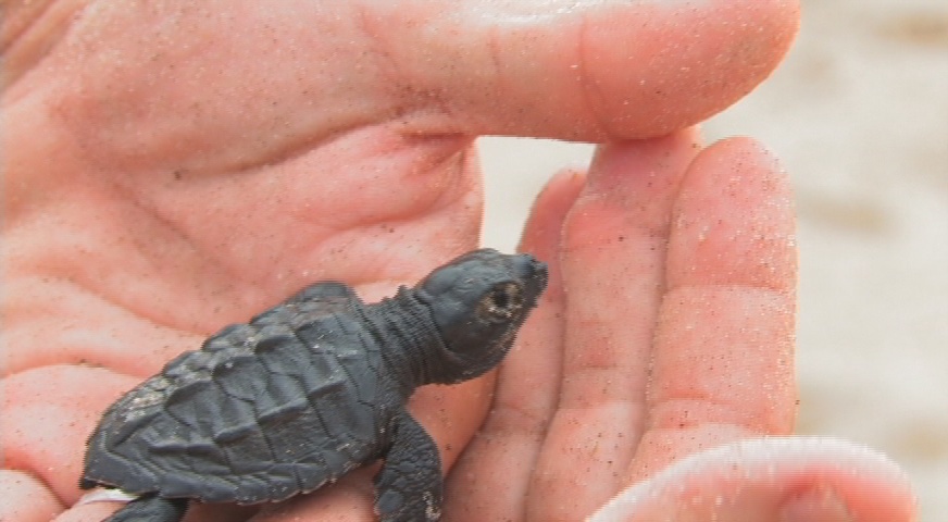

Bruce- Here's a few caps from last week. HDV to SD and 24 p/f on the A1 and HV20.
HV20 and GL2 ( in Ewa -Marine Bag) are just on semi auto with a warm white balance.
The A1 on the turtle is manual, no preset with a very warm color balance (on the top of the cam)
The sunset is my own really saturated preset.
You can compare.
The A1 colors out of the box from....HELP!-gl2.jpg   The A1 colors out of the box from....HELP!-hv20.jpg
The A1 colors out of the box from....HELP!-a1-1.jpg   The A1 colors out of the box from....HELP!-a1-2.jpg
Eric Weiss is offline   Reply With Quote

Join Date: Feb 2003
Posts: 339
Here is the A1 frame taken at the same time
close by with the 2 units lens side by side approx 6-9 inches apart on pods.
Shooting mode was HDV1080 60i/TV 60 mode with the iris cranked on "wide open"!!
Keep in mind this was taken with no gain and with the stock factory settings out of the box.
Well,I guess the Equivalent TIFF file is bigger than what I can upload here.
So,here is a tiny jpeg file which will have to suffice.
Will mail orig tiff file on request
Sorry!

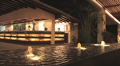

Eric,I missed which picture out of the 4 was the
GL-2 one. What camera took what shot?
Sorry I missed it.
Liked the sunset picture.
Would you be willing to do a indoor shot,at night and post 2 pics of the same thing like I did please?
It looks more and more like I have a bad A1.
Thanks,more to come on another night.
Bruce
Bruce Pelley is offline   Reply With Quote
Old October 3rd, 2007, 08:40 PM   #27
Location: Philly,PA
Posts: 360
Cripes man, both of those grabs are heinous!
The A1 looks clean, albeit dark, for out-of-the box. I’ve never used “TV mode” but I suspect that’s your problem.
Color me presumptuous, but I think you may have a defective GL2!
What the hell with that tiff? It looks like it was taken from a ’94 web cam.
Edit: Your GL2 tiff at 100% is over 720X480 on my screen. At 50% it looks correct.
Mouse over my pics and the file names are the model. The GL2 is the 4x3 turtles going into the water.
I’ve uploaded some “low light” A1 grabs. I’m a little busy right now editing this turtle stuff. Trust me when I tell you that both the A1 and Gl2 should take noise free, well light shots of your scenes. It’s a living room with a 60 watt bulb right? There should be no issues.
Honestly, I have no idea what’s going on with your cams. Green Box both and take those again.
The A1 colors out of the box from....HELP!-a1-low.jpg   The A1 colors out of the box from....HELP!-fire-a1.jpg
