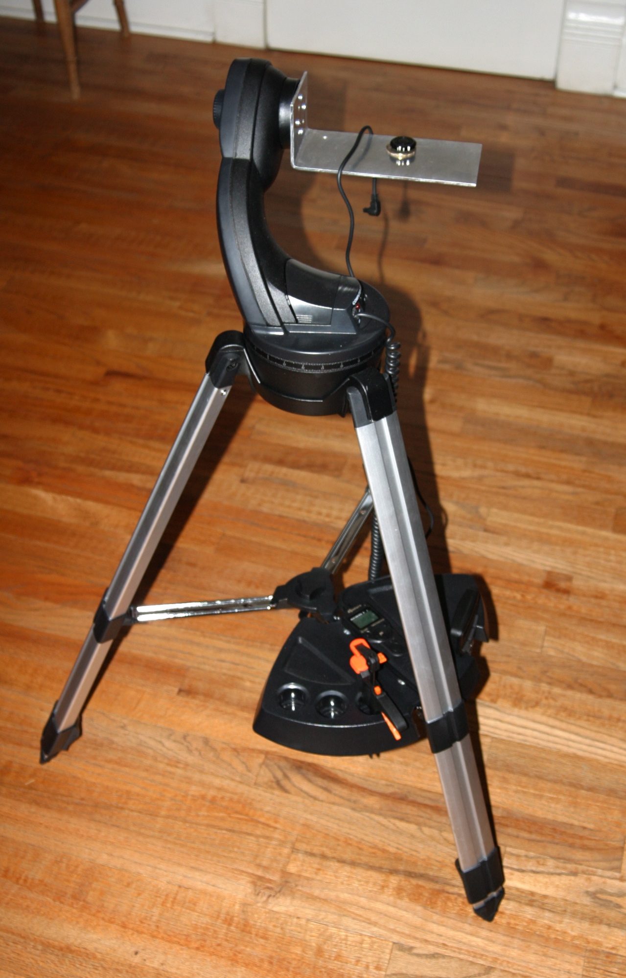

Old October 27th, 2007, 11:59 AM   #13
Location: Little Rock
Posts: 1,383

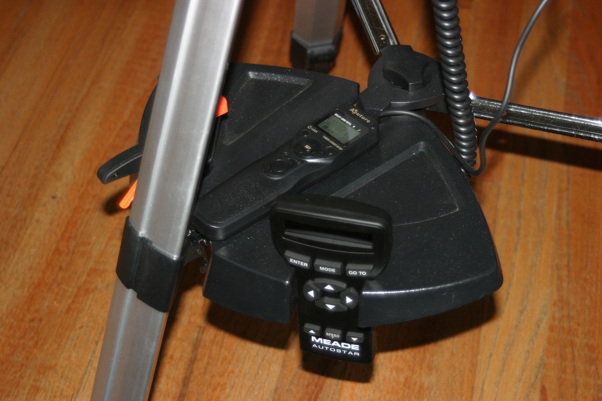

Depending on the project, sometimes I will tether a laptop computer.
But most of the time I use an inexpensive Aputure brand controller, which is a knock-off of the more expensive Canon unit.
I use a Meade dual-axis telescope controller for motion time lapse work.

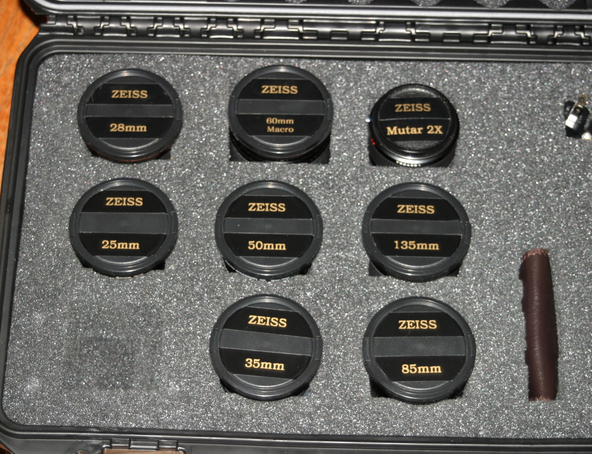

And my old Zeiss lenses perform double duty. They work great on my Brevis teamed with the XH-A1, as well as my Canon DSLR.
