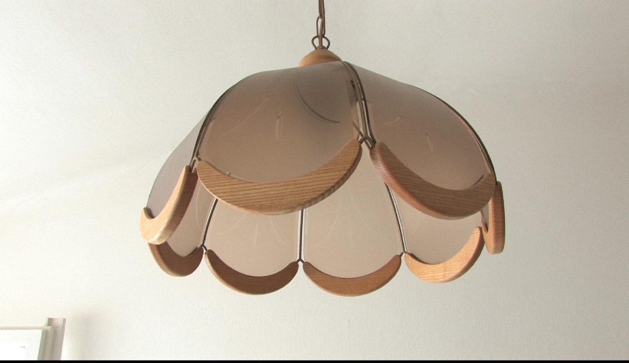

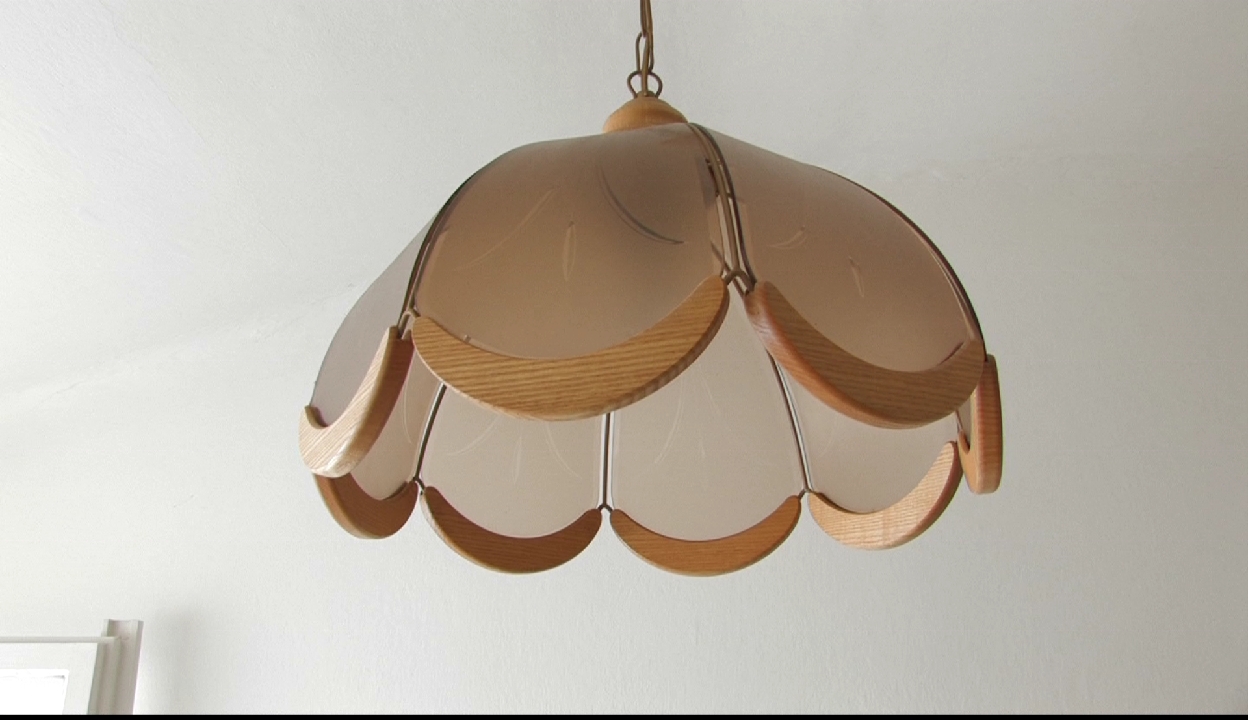

This is my experience only.
first I use with gama2, gain+12dB (with less details is noise less visible)
second I use with gama normal (and gain +6dB only).
see attachments (specially glass parts of the light, noise).
Try both setting...
HDF and DHV settings-l-4-gaman_default.jpg   HDF and DHV settings-m-0-gama2.jpg

You mean, first is shot with HDF M, DHV 0 and second - with HDF L, DHV 4? First of all, what do you mean "with less details less noise is visible"? Did you mean with lesser DHV less noise is visible? I do not think so, because DHV is just a ratio, not the absolute measure (nevertheless, probably you mean that).
Did you mean with lesser HDF less noise is visible? This contradict with the fact, that lesser HDF makes picture sharper (doesn't it?) => more noise visible.
Secondly, in my opinion, first picture is much more noisy than second one, despite of the fact that it is dimer. This is quite logical, but didn't you expect me to come to opposite conclusion, posting this?

Pictures have names - you can see, that more noise is with "L" (low), lesser with "M" (middle) setting of DHV (and result is diffrent from setting sharp..).
Try some adjustment (BLK M, PED -3, NR 0+0 , color you like) and than try both setting:
- gama normal + L + 4
- gama 2 + M + 0
On good CRT monitor you will see, that there is some different results. I can't help you more (can't tell you more .-) ), you must try this and you will see...
Result with gama2 +12dB have more brightness with the same noise as normal gama with +6dB (try both DHV M and L). It is experience, I use it.
