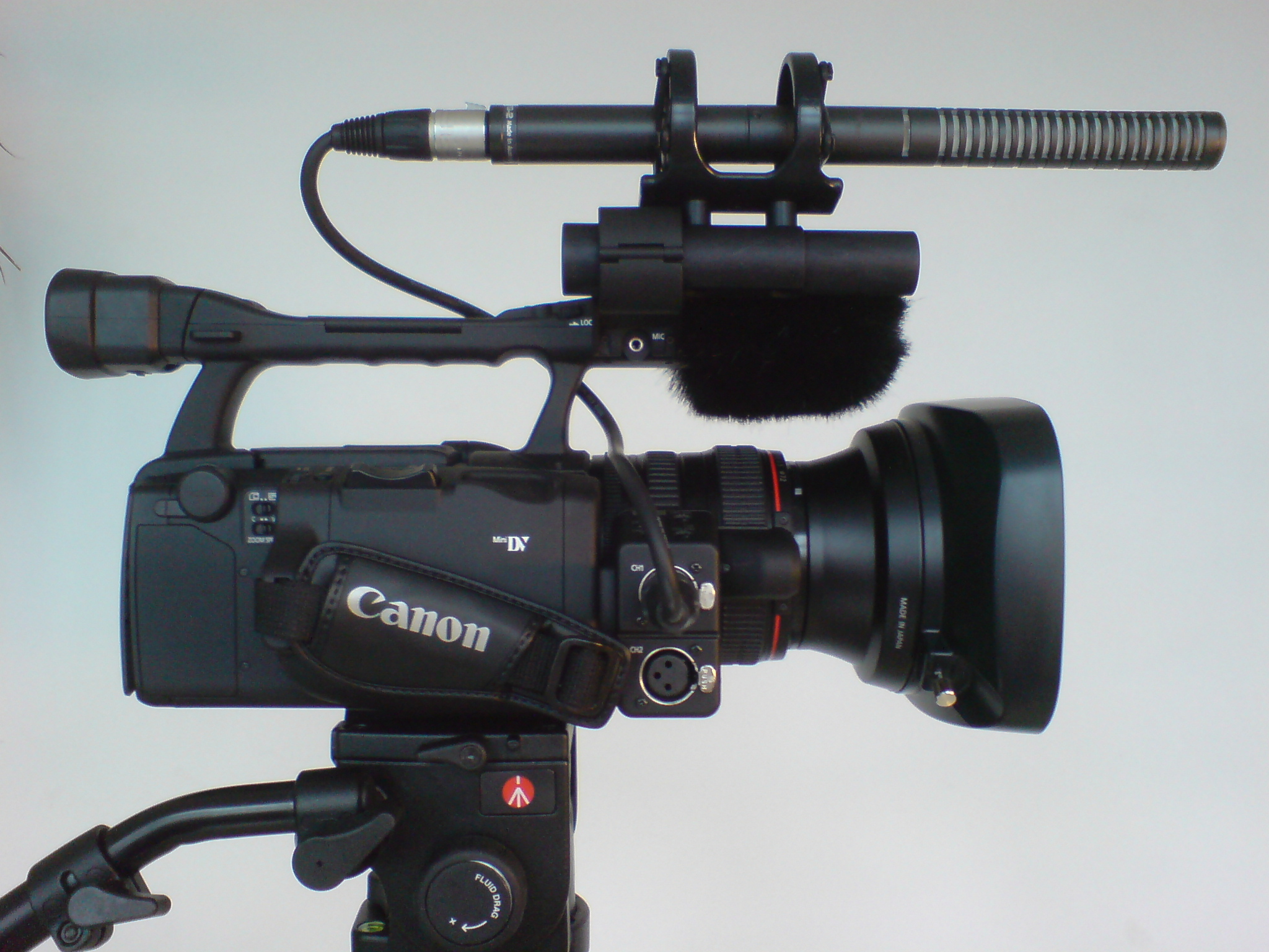

Rode SM-5 is a cheap and good shockmount

I second the use of the sm5. It also gets the mic further away from the lens when you mount a deadcat or other wind noise reducing device.
