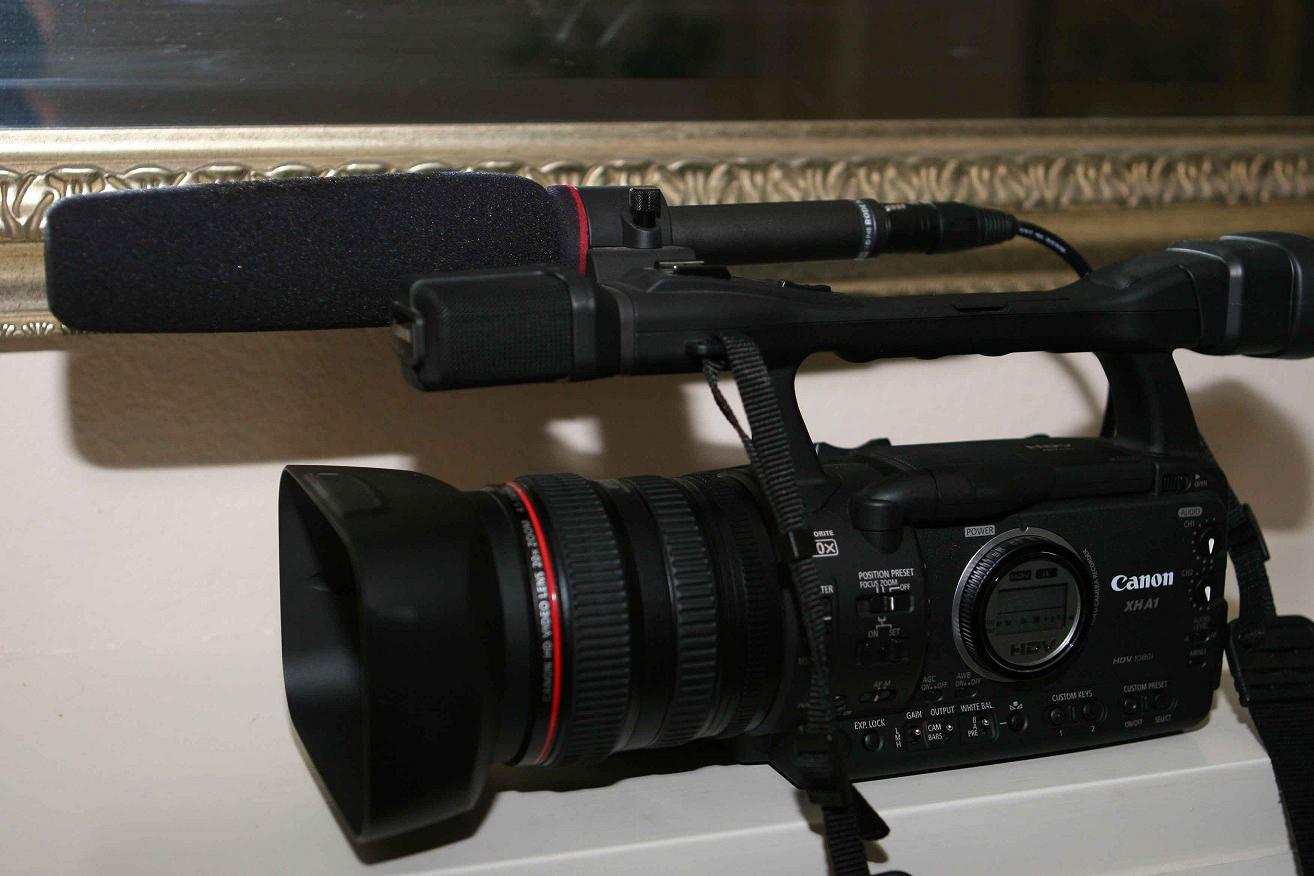

I performed some minor surgery on a foam grip from a Razor-scooter, giving it a paint job along with a red pin stripe and presto bingo a “Canonized”(pun intended) foamed mic mount.
