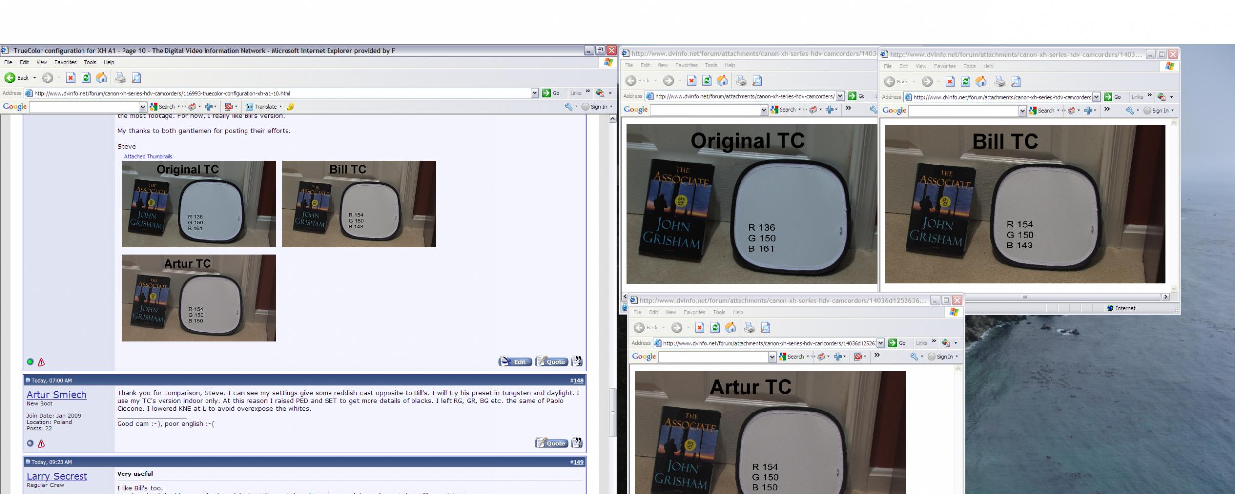

Originally Posted by Bill Busby View Post
What's funny is... I noticed on the last set of photos Steve posted there's discrepancy between the thumbnail representations and the images opened... but only on the LCD connected to this PC
Thumbnails:
original TC has the blue cast many have noticed.
the other two, mine and Artur's look fine.
Opened images displayed:
original TC looks great. No blue! White is white! :D
mine and Artur's white's have a reddish cast! :D
Bring these into PS CS2 using the "auto levels" or "auto color" on all three, the original isn't altered much and looks quite good, while mine and Artur's will get noticeably washed out looking. :D
I know this isn't a correct method of comparison, but it was a funny observation.
Haha! That is strange! For grins, I just repeated what you did, minus importing into an NLE for adjustments. Below is a screen grab of my picture post above that is juxtaposed to the three opened images on the right, shown in their respective windows, and positioned in roughly the same orientation. I can't see any difference between thumbnails and opened images on my monitor.
Steve

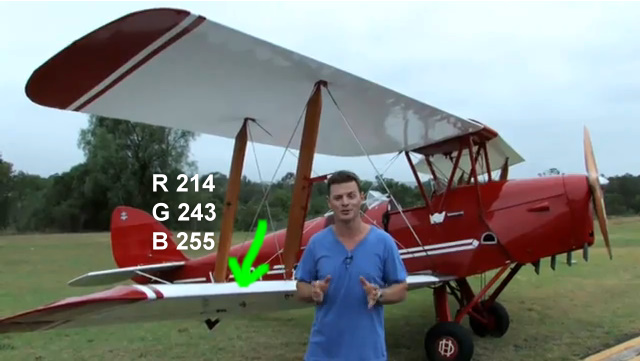

And what do you say for that? I suppose the wings are white?

Artur beat me to it. Your images have that dreaded blue cast, Mark...unless, of course, that's the look you're after.

Thanks for the test Artur. I was using the factory preset previously, so was impressed with the more vivid colors of trucolor. I didn't pick up the blue cast, wings were white. Back to the drawing board :(

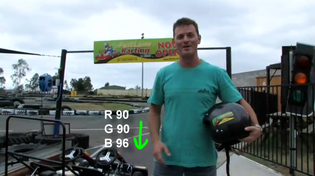

There is something strange. Greys and blacks are nearer to right values. Whites tend to blue, isn't it? Take a look at this:

Why, Mark? It's done for you. Try the slightly revised preset in post #144 of this thread. I did and it completely removed the blue cast whilst maintaining the other colors wonderfully. I've been shooting outdoors with it and I can say that the footage straight from the A1 looks just terrific.
