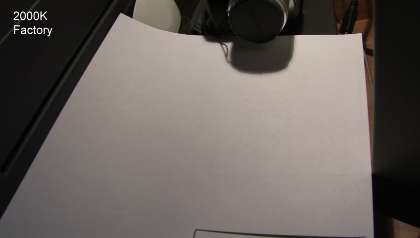

Blue cast at TC

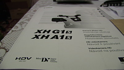

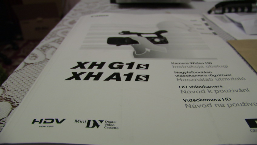

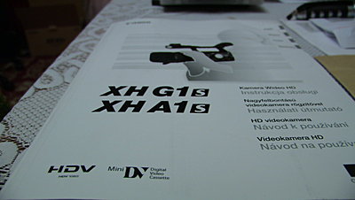

I want to refresh this topic. I'm new owner of XH A1s. I also notice blue cast at TrueColour preset. Here are my shots with fabric preset and TC.
http://img19.imageshack.us/img19/3279/img0113syb.jpg
http://img26.imageshack.us/img26/8641/img0114wcr.jpg
http://img26.imageshack.us/img26/2732/img0115q.jpg
http://img26.imageshack.us/img26/2012/img0116fgx.jpg
What to do with it?
Artur Smiech is offline   Reply With Quote
Old March 24th, 2009, 05:11 AM   #124
Location: Elgin, IL
Posts: 249
Artur,
Did you manually white balance before shooting?
Michael Hutson is offline   Reply With Quote
Old March 24th, 2009, 09:55 AM   #125
Location: Poland
Posts: 24
Originally Posted by Michael Hutson View Post
Artur,
I set manually, automatically and pre-defined. I shoot in daylight and tungsten. Always the same: blue cast. I can post other shots if needed.
Sorry, if my english is poor.

Hi,

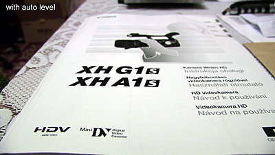

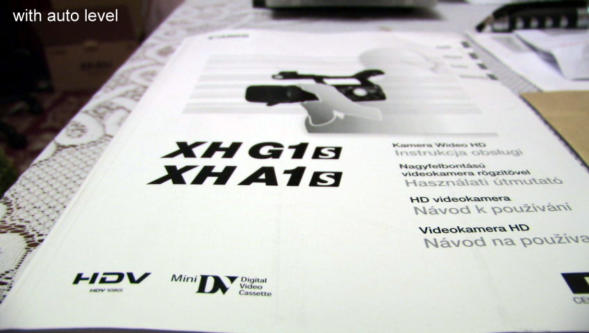

Thanks for reply. Images above are auto WB. Curtains and window are white. Here are some shots took this evening at tungsten light. Manually white balanced.
Last name your mother was probably Nawalaniec. It's typical polish name :-)

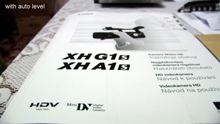

Edit: I noticed that using Auto level function in my PhotoImpactXL produce almost white balancing images. It means nothing of course.
TrueColor configuration for XH A1-img_0139.jpg   TrueColor configuration for XH A1-img_0140.jpg
TrueColor configuration for XH A1-img_0139a.jpg   TrueColor configuration for XH A1-img_0140a.jpg

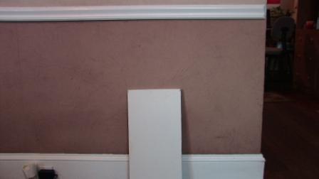

Here is a comparison of "no preset"(LEFT) and "truecolor"(RIGHT). The white board is a painter's canves that I used to manully white balance. I will let you look and see if the blue is there. (NOTE: I had to increase the db setting on truecolor....low lighting in the room....it made the pic a bit lighter)
My white balance procedure:
1. Select a custom preset; and VERIFY custom preset is "ON".
2. Zoom in on white board. (I do not focus)
3. Press white balance button until it stops blinking.
If you don't see the blue in my pics, you might want to check the trucolor set up to make sure all values are correct in the setup.
Hope this helps, Artur.
Regards,
Michael
TrueColor configuration for XH A1-img_0187-no-presets.jpg   TrueColor configuration for XH A1-img_0188-truecolor.jpg

Hello Michael,
Thanks for help. I'm at work in office now and will test it at home later.
My procedure:
1. manually white balance on white page without any preset
2. turn preset on
3. shot
Do I something wrong? Does any preset influent on white balance? I thought every preset manages an image AFTER white balancing.
I see slight blue cast on your Truecolor's shot. Take it to your graphic aplication and test it by eyedropper. I will do it too.
My shots has been taken without gain.
And last but not least: Nawalaniec doesn't mean "baker's son" :-) It's difficult to explain what it means. This word probably origins from verb "nawalać" which has many meanings.
Sorry, I think polish and write english - I hope you won't cry of angry or laugh :-)
BTW: my last name "Śmiech" means "laughter".

Change your procedure.
1.TURN ON PRESET
2.WHITE BALANCE ....I think that is your problem.
3.SHOOT
Old March 25th, 2009, 08:12 AM   #132
Location: Poland
Posts: 24
Thanks, Michael!
It's 3 p.m. I finished work and go home to test it. I do as you wrote.

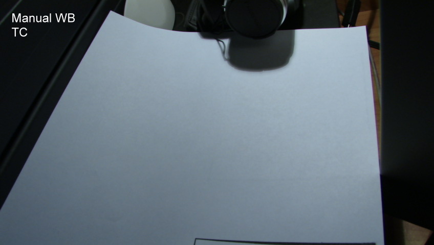

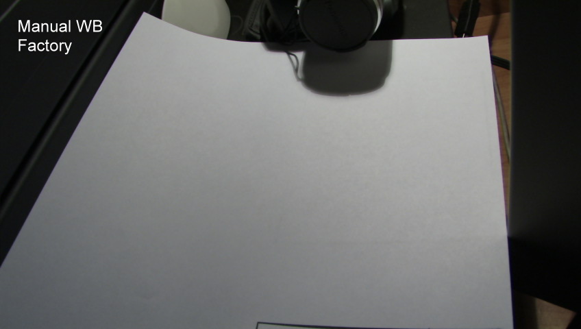

It's 6 p.m. I'm at home and did your procedure. It's all the same. I will try to modificate this preset. Did you noticed that black parts are black and only white tend to blue? Upload images, put them into Photoshop (or similar) and use eyedropper.
TrueColor configuration for XH A1-img_0153.jpg   TrueColor configuration for XH A1-img_0152.jpg

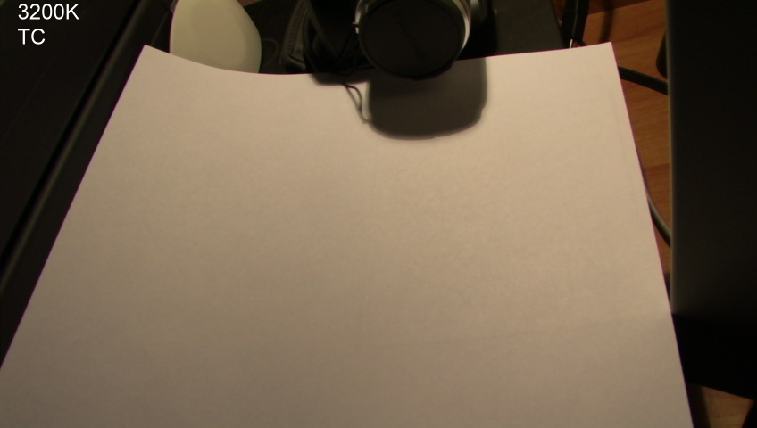

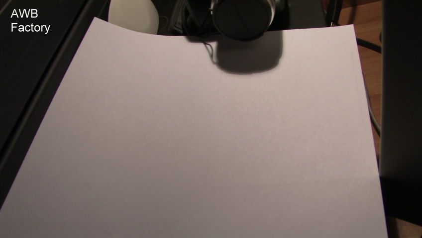

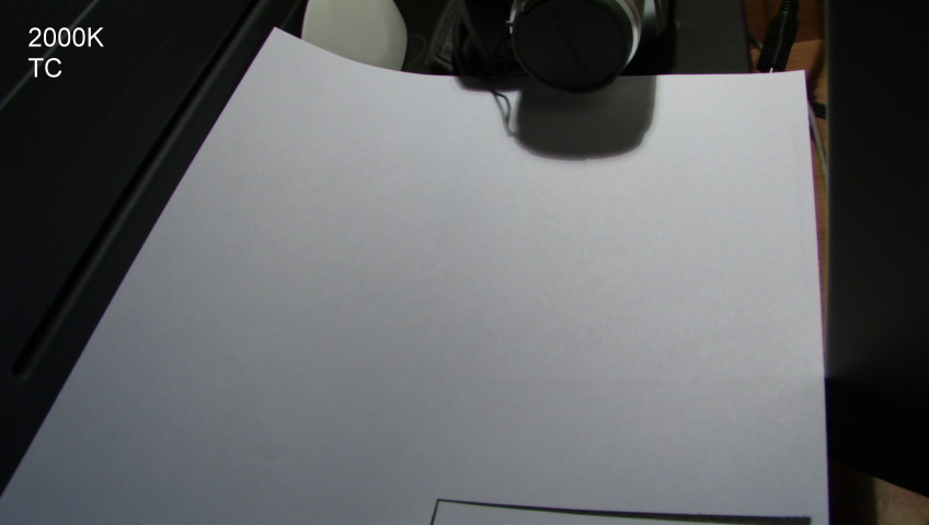

One thing to be aware of is that auto-WB and manual temperature dial-in can produce very different results. WB definitely adjusts more than the single color temp.
On that note, I get a blue cast when using WB with truecolor, but not when manually dialing in the temperature.

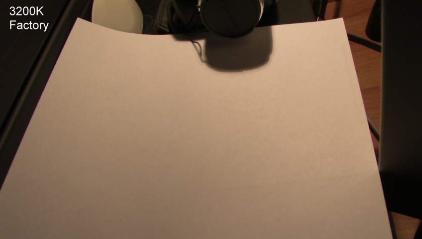

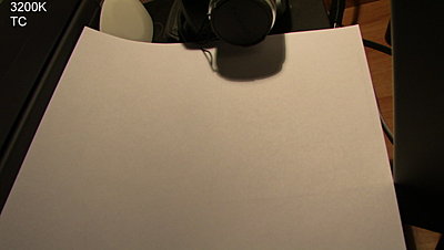

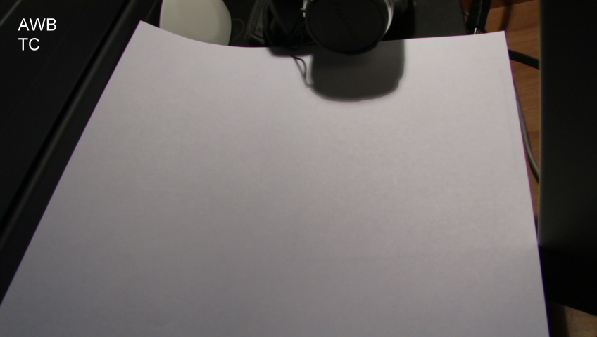

These shots was taken at small halogen lamp on my office-desk (20W of power).
TrueColor configuration for XH A1-img_0154.jpg   TrueColor configuration for XH A1-img_0155.jpg
TrueColor configuration for XH A1-img_0156.jpg   TrueColor configuration for XH A1-img_0157.jpg
TrueColor configuration for XH A1-img_0158.jpg   TrueColor configuration for XH A1-img_0159.jpg
TrueColor configuration for XH A1-img_0160.jpg   TrueColor configuration for XH A1-img_0161.jpg

Hello Michael,

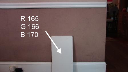

Here are your shots I meassured in my PhotoImpactXL. There is slight blue cast yet :-(
