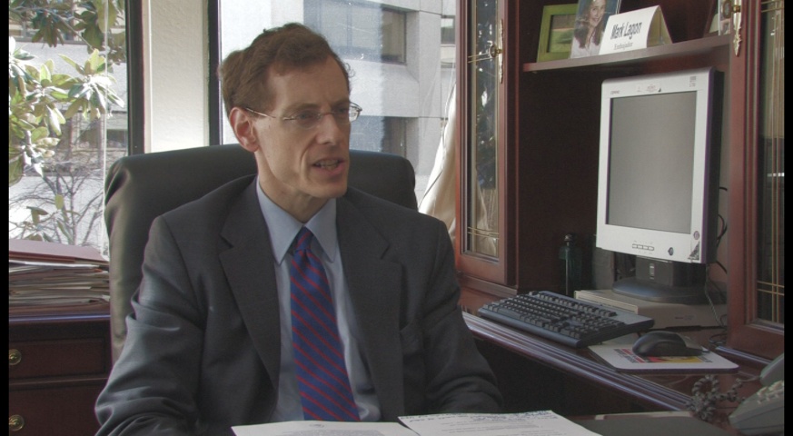

I've found that Cine gamma doesn't in fact darken the picture, but because the gamma curve is different, the image appears darker on the camera lcd. You'll notice the zebras change, but the exposure meter doesn't. What I've learned to do is to expose turning the preset off, then turn it on and trust that the image when it's captured will be fine. And it is.
An example attached. This was shot in an office building with no extra lighting. There's lots of windows, but the subject himself appeared much darker on the lcd with the preset on. This was with Cine 2 Gamma and Blacks Stretched.
But if the image isn't really darker, it only appears darker on the screen, surely you don't have to adjust the exposure?
