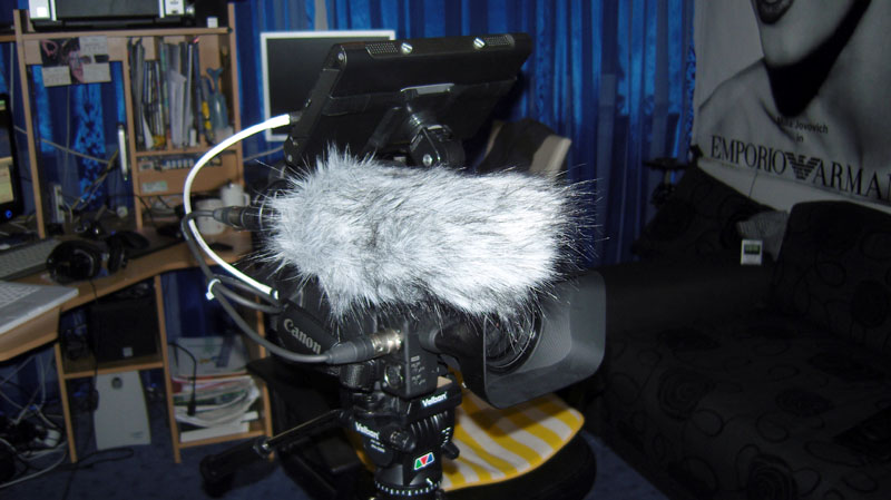

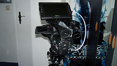

does anybody know if the NTG2 with the Rode SM5(+deadcat) comes into the frame when used on an XH A1 with/without wideangle lens?

I have the same set-up. I do not have a problem. The SM5 can be set back as well if need be which would bring the NTG2 in closer to the camera operator.

Posts: 30
Originally Posted by Terwingen Niels View Post
Hi,
gtrz
No problems here...
