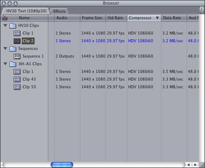

I finished running my tests mixing footage from my XH-A1 and HV-30 this morning. All footage was shot at 30f/p and captured using the 1080i60 Firewire Basic Easy Setup in Final Cut Pro. As I suspected, there was no problem placing the captured footage from the different cameras in a 1080i60 sequence (using Final Cut Pro 6). This makes it pretty clear to me that the problems you were having mixing footage stems from the 1080p30 Easy Setup you used to capture your footage. My suggestion is to ignore this Easy Setup and capture all of your 30f/p footage using the 1080i60 Firewire Basic Easy Setup. The footage is marked "1080i60" under the "Compressor" section of the browser, but the footage is clearly progressive (image below).
If you have any more questions, please don't hesitate to ask.

I just put a multiclip sequence together using the footage from both cameras. The clips combined with no trouble at all. They share the same codec, frame size, and rate, so mixing the footage is no longer an issue. As I said before, I suspect that the trouble mentioned in the 1st post of this thread stems from using Final Cut Pro's 1080p30 Easy Setup. If you ever use both cameras for a project capture your 30f/p footage from both cameras using 1080i60 Firewire Basic.
