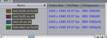

Did you ever get this figured out? I'm suddenly dealing with the same issue. Like you I shoot with Canon XHA1's at 30F and HV30's at 30P. When I capture them into FCP 6 the HV30's show up as 1080i60. The XHA1's show up as 108030p. This happens regardless what camera is used for capture, the A1 or the 30. I've even tried Capture Magic HD and had the same results.
http://www.dvinfo.net/conf/attachmen...1&d=1228804353
This is fine except for when I want to create a multiclip. I get a warning that the codec types are not the same and therefore multiclip isn't possible. I am shooting 30p and 30F mostly to avoid the extra step of running all of the HV30 footage through compressor for a reverse telecine when shooting both at 24. Am I doomed to always have to run half my footage through Compressor in order to do a multiclip? And don't even think of trying to create a reference movie from the sequence that just may have the same codec type - HDV always has to conform so it takes eons for it to export even if all you want is a reference movie rather than one that is self contained. I miss the predictable sd days...

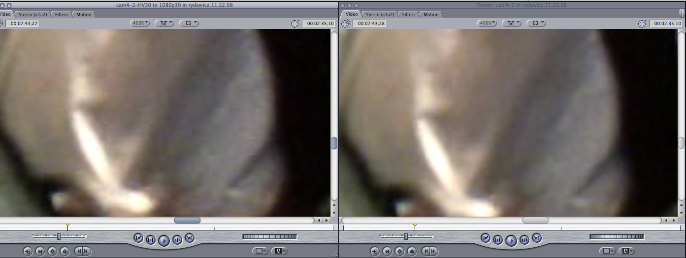

Here's what I've decided to do for now - I'm converting the HV30 material that I need for the muliticlip as a HDV - 1080p30 file in Compressor. I take a hit with a compression cycle but until I figure out a faster more efficient workflow this will have to do. I tried exporting the HV30 footage as ProRes - 1080p30 but that gave me the same 'not the same codec type' error, so it has to be HDV. The cons are the quality hit and the time it takes, but I make that up in the space requirements. I run through up to 15 hours of captures every week so whatever I decide to do it has to be fast and efficient. Below is a still of some artifacts that occur as result of the 1080i60 to 1080p30 HDV conversion. (This is a screen capture blown up 400% in two viewers.) The left is the converted file - notice the blockiness in some of the nondescript areas. At 100% they are not noticeable.
http://www.dvinfo.net/conf/attachmen...1&d=1228851299
