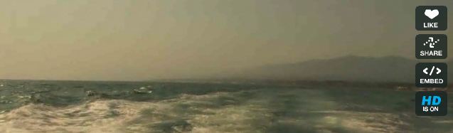

I've got a screen capture here that I think shows what you're seeing. The fade that is right after it also shows some compression artifacts
http://www.dvinfo.net/conf/attachmen...1&d=1226460882
What codec are you using for your renders? The contour lines in the sky are a sign of a codec that is taxed and isn't up to what its being asked to do. I'm no expert in this area, but if you're really looking to improve the image quality it seems like you may want to bump all your source footage up to ProRes HQ and render in 10 bit. The noise and blockiness at the fade are compression artifacts that are also caused by a codec being asked to do too much within the restraints of the data rate it has to work with, i.e. DV/HDV, ProRes, ProRes HQ, Uncompressed etc. (I'm assuming you're on FCP.)
Some questions regarding XHA1 / HDV-screencap1.jpg

For this, I have just simply been capturing as 1080i60 HDV and rendering in HDV as well. I have found that simply just changing the Render codec in the Sequence options menu will mess up my timelines after I try to export: (My "Green Render Status Bar" will revert to being RED: unrendered) That is neither here nor there, because I guess I could just convert ALL the footage to ProRes422... I don't how I would do that at this late stage in the editing process (I already have about 30% of a 35 minute film edited in HDV).

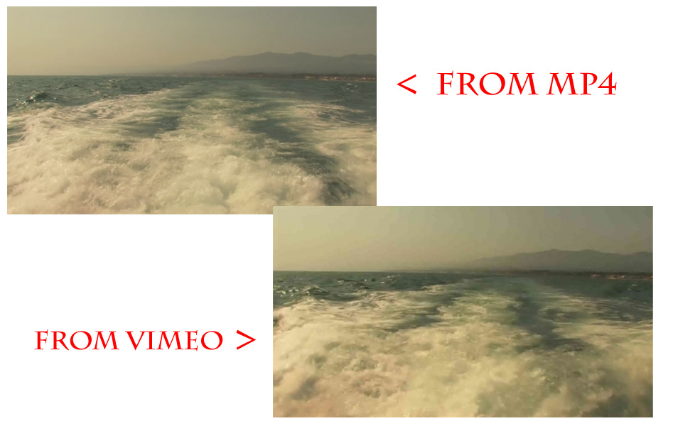

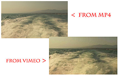

Here are a couple of pics comparing the MP4 to the Vimeo Flash encode... clearly, the flash is adding some additional artifacts (the stills aren't from the exact same frame, but close) In a couple days (when I get back to my editing workstation) I'll upload a pristine JPEG from FCP...
Some questions regarding XHA1 / HDV-mp4vsvimeo.jpg
