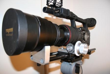

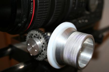

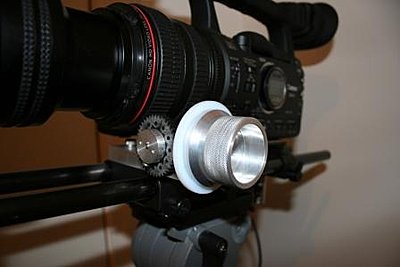

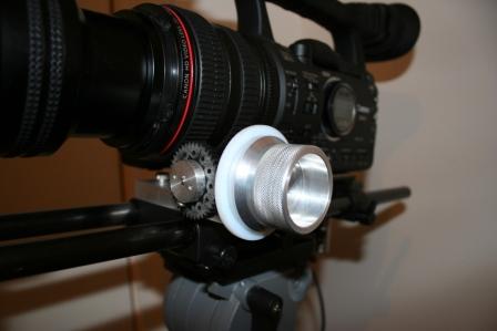

I have been looking for a follow focus system for the XH A1 but needed it to be usable on the fixed lens since i don't have a 35mm lens adaptor. I do use a Raynox tele converter so i ended up buying a set of rails to help support that, meaning i had the rails to support a follow focus, but so far, i have only been able to find one follow focus system that works with a "friction" wheel. Not knowing just what the quality would be like of that one, i decided to give it a go to make my own. I started looking into small gear boxes but was put off by the ridiculous prices of these, i mean, over $400 Australian i think is a joke. Anyway, in the end i just bought some gears, some bearings & some stainless steel rod to suit on the internet. The whole thing pretty much, is made out of aluminium, & i made it to suit the set up i have rather than trying to make it adjustable since i figured it was only for my set up & wouldn't need to be changed. The gear that drives the focus ring on the lens is a nylon gear that comes from a "hobby set" of gears, it just worked out that it meshed with the ribbing on the lens ring perfectly. I still need to do some minor tweaking with the nylon gear as it is not perfectly centered, but that won't be too difficult to sort out. I may even make up a whole new gear from aluminium, but first i'll see how it goes with this one.
I haven't played around with it too much yet, but from my initial tests, it works very well, & focusing is much easier.
Bryce

The Indifocus was the one i had seen with the friction wheel, but that's the only one from what i have seen. If i had added up all my time to make this, & the cost of the parts, then it probably would have only worked out a little bit cheaper than the Indifocus, but i sure had fun making it!

Wow! I had never used a follow focus before i made this one, but now that i have, i wonder how i ever did without it! I have just spent a few hours using it, & i can't believe how much easier it is to adjust focus. Not only is it a more natural movement that you make when using it, but the adjustments to the focus that can be made are far more precise.
As i wrote in my first post on this thread, i need to tweak the friction gear to make it work better, & now that i know how well it works, i am really keen to get it sorted. I also want to drill holes in it to reduce the weight as much as possible, & do the same to the lens support i had made earlier to support the Raynox tele converter. I will then look in to getting them both anodised in matt black, which should make them at least look a bit more professional.
Bryce
