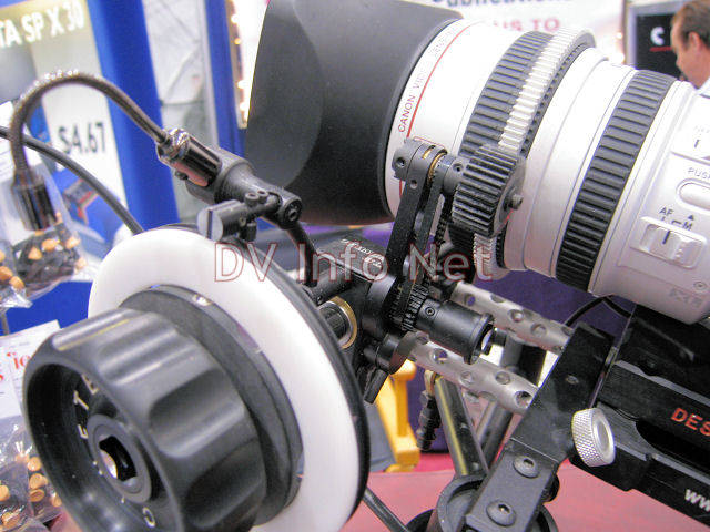

So far the best follow focus solution I've seen for these particular lenses comes from my friend Karl Horn out in L.A. -- basically it's just a geared ring that fits snugly over the lens control ring. No reason why you can't have one for focus and one for iris. I hope this pic from NAB does justice to the concept. It's showing an XL1 but the same idea applies to these cams.

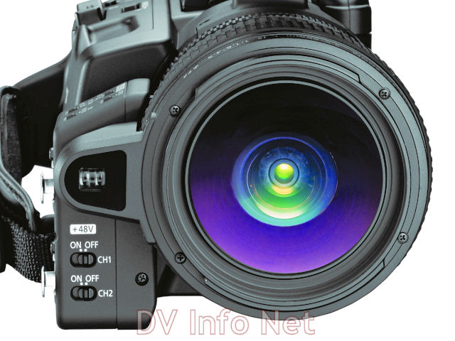

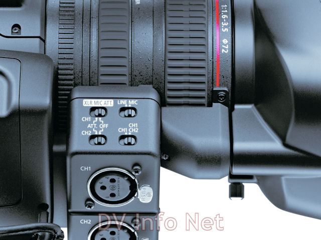

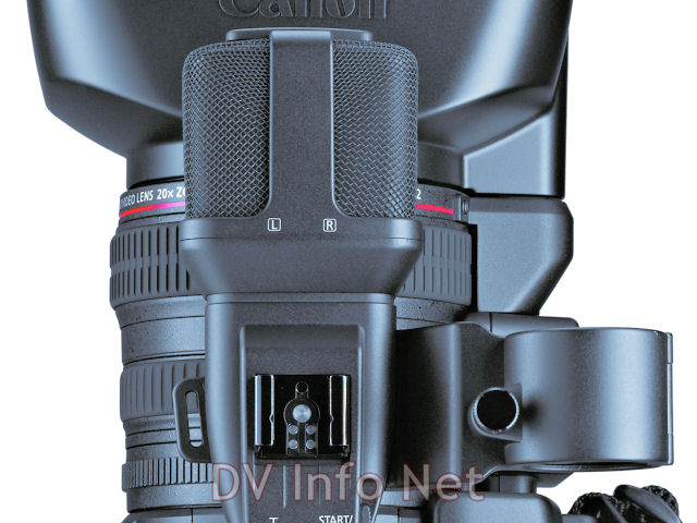

I was thinking about this and realized there's a physical limitation on the XH camcorders that will prevent the slip-on geared ring idea from working. If you look at the photos included below, it's pretty clear that the Instant AF sensor and the XLR audio input module over on the right side of the camera body are going to prevent you from slipping anything over those lens control rings. I don't know why I didn't think about this before responding to Jack's post.
If you can't see the attached images, just go to http://www.dvinfo.net/canonxh/articles/images2.php and look at the fourth photo down from the top and you'll see what I mean.
Follow Focus for Canon XH-640front1.jpg   Follow Focus for Canon XH-640front2.jpg
Follow Focus for Canon XH-640front3.jpg   Follow Focus for Canon XH-640front4.jpg
