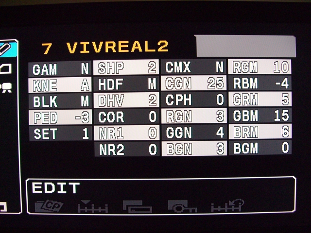

I shoot almost exclusively Outdoor video ( hunting & the like ) . I have been using VIVIDRGB with good results. One area I find difficulty in is shooting during a firearms season where Blaze Orange is required to be worn by the hunter. It seems to give the camera fits. In VIVIDRGB it's no longer Blaze Orange - but a more burnt orange. I know that a preset like PANALOOK2 will help - and I do have that on my list.
Any other suggestions for presets that I might try ??

Try my preset called Vivid Real 2 (VIVREAL2), which I created to be relatively realistic with a bit of punch to the colours, I've tried to tweak it to be reasonable in lowlight and to be overall not a million miles from my HV20 which I also use for cut scenes. I've always found VIVIDRGB too saturated, I quite liked LOWLT-3 but for the ghosting though in low light it was good. PANALOOK2 was a touch bland for me. But again everything is subjective (or we'd all be using the same preset). PS: I use it a 0dB.

Brian,
I'm having trouble getting that preset to copy to card. Do you have the settings in text format ?

You probably need to rename it to (say) PRESET01.CPF to make it visible in camera but the settings are as below
